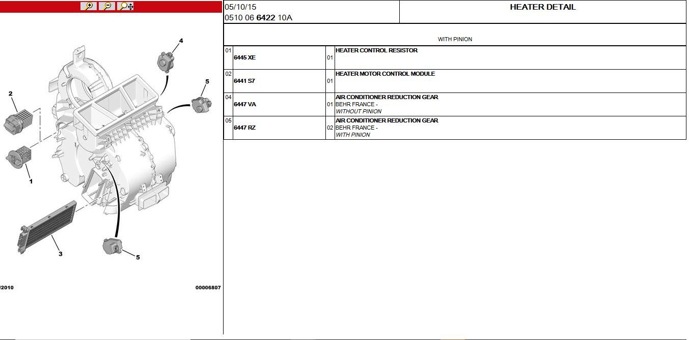

Need help cannot locate heater resistor on 2006 Citroen C4 sx

Re: Heater resistor location Citroen C4 SX 1.6 2006
Unread post by Fake Concern »
It's below the heater blower motor top left hand side of heater housing in passenger footwell
