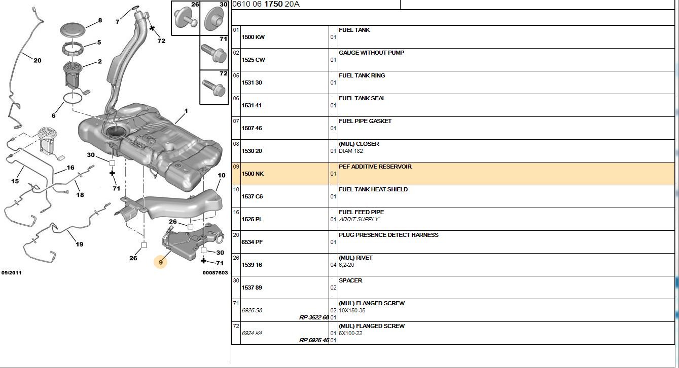

Apologies for the question, but it’s specific to my car. In a nutshell, I cannot find any info regarding whether or not my 2008 C5 Exclusive tourer actually has an Eolys system fitted. I can’t see anything in any of the menus, and I’ve scoured the underneath of the car looking for a filler cap and tank to no avail. Could somebody tell me what’s what please?

Yes, it's got one, here's the pic of the tank:

Thanks Richard. Now, next question, how do I know if it needs fluid. I’ve had the car for 6 months and the previous owner did 155,000 miles in the car and has no knowledge of any fluid refill. His service history paperwork shows no record of top ups. Surely it must be empty by now?
Also, how is this fluid injected into the system? Is it bled into the fuel tank by suction, or pumped somewhere on command from the engine ECU. I don’t see any electrical items on that diagram.

Don't worry about it until it tells you to top it up. Distance remaining is calculated by the engine ECU based on estimated quantity of additive in the tank remaining (it is not physically measured) and the distance until the next due service interval. If it thinks there is insufficient additive remaining until the next service it will flag the warning up to top it up. In either case when the warning comes up, there is generally sufficient for 500 to 1000 miles depending on driving conditions of course.
Injection is controlled by the engine ECU afer deciding on whether, and if so, how much fuel has been added to the tank. The additive system then injects the relevant quality into the tank.
