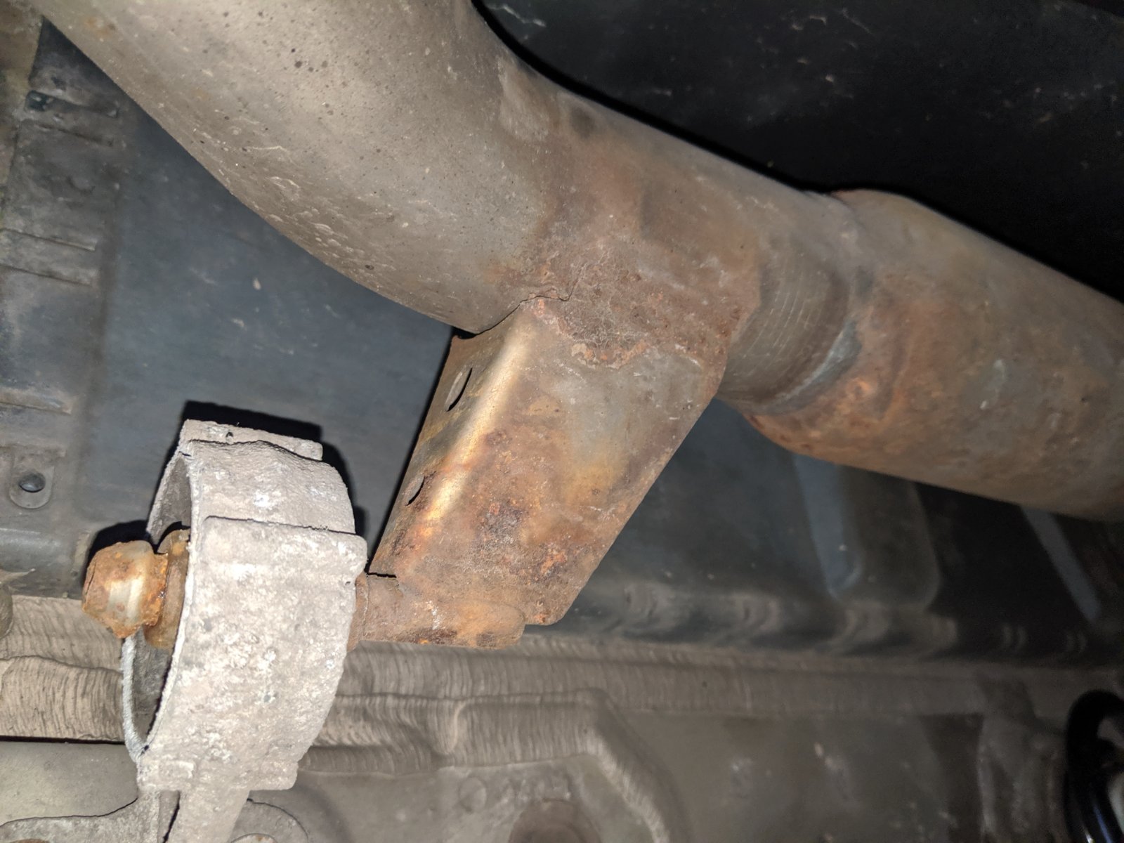

I've had a quick look under the back of the car at the exhaust and it does move around a bit.
I can't see fully where the mounts/hangers are - and I could only see one mount right at the back of the car where the exhaust ends.
The rubber mount feels really old and dry and just slides around.
It's a circle rubber mount (see photo) contained in a metal circle frame.
Are there any more mounts on the exhaust other than that one?

Re: C4 Picasso - dull thud from rear of car
Not a clue on the C4 but a deteriorating exhaust hanger has been known to cause similar thumps as the exhaust contacts the underbody.
Just a guess really and Marc's suggestion of failing bump stops equally valid.
