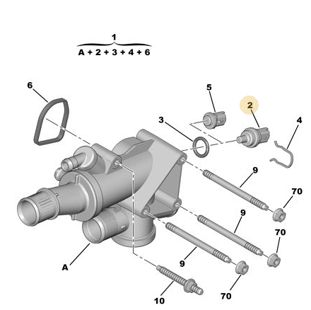

Re: C5 X7 water temperature.
So both the same variant of engine:
Item 2 is the water temp sensor in the water outlet tank
That's sneaky.
Yes, 133 is the one I would consider normal the other is reading much lower, I suspect the reading was dropping as I was driving home but the heater was still good.
Thanks for the info.

If it's item 2 for your VIN ending 006, then it's part number 1338C1

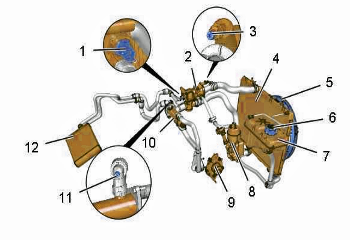

Cooling System Data
Setup for Manual Six Speed on DW10BTED4 Engine without Additional Heating
(1) Temperature sensor.
(2) Coolant outlet housing.
(3) Bleed screw(s).
(4) Engine cooling radiator.
(5) Fan.
(6) Filler plug.
(7) Header tank.
(8) Coolant/oil heat exchanger.
(9) Coolant pump (Mechanical).
(10) Exhaust gas / water heat exchanger.
(11) Bleed screw(s) .
(12) Heater matrix.
(3) Bleed screw(s).
(5) Fan.
(6) Filler plug.
(7) Header tank.
(12) Heater matrix.

Thanks for all the info Marc and Gibbo. The listing is obviously incorrect then but you can get the complete assembly for about 30-40 pounds so I will go down that route.
I suspect after my journey yesterday that it is the thermostat, it was only about 4-5C and the temperature went from 2 to 4 bars depending on whether we were going up or down hill so I think the thermostat is not closing completely. If I change the assembly that should take care of both possibilities.

- x 6963
Part 1336Y9 is the part number for the outlet tank Peter. So that would appear correct.
