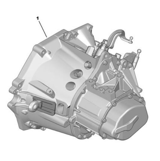

Hi again. The gearbox has been removed from this car today. The clutch plate on its last legs, the release bearing is had it and there is big play on the gearbox shaft. It needs a replacement gearbox. Can someone with service citroen please look up the gearbox code and what, if any vehicles have a compatible gearbox. I dont have the chassis nimber, just the reg, SL58XHZ. Any help is appreciated.

- x 6945
Re: Picasso clutch issues
A bit late to the party (dentist).
I have the VIN and can confirm no DMF on this model. It's a DV6ATED4 engine.
As for the gearbox - you've not mentioned component parts - so I'e assumed the complete box.
Part numbers:
New part no: 2222QS Markings: DP2J, DP29
Exchange: part no: 2223ZF Markings: DPB9, DP29 DP2J
Model for both: CP 19X72
Part numbers:

Thanks marc. Yes, the flywheel is solid and good. The input shaft on the box has quite a bit of play in it, suspected its been running with no oil for a while damaging it. Mechanic says get a box from a breaker and fit with new clutch will be the way forward, hence the wondering what other vehicles are the same

- x 6945
Apart from this variant of Picasso, the only other vehicle with this part number (2222QS) showing is a Berlingo VP (M59) with the DW10D engine specifically....

A gearbox was found this morning and is fitted and the car working again. The box came out of a pug 307 1.6 hdi. The car has now cost too much really, but has a new clutch. I have felt guilty as I got the car for my friend, but I know it is one of those things. She has been using my c1 while her car has been broken, she works in the same shop as me so I've still been using the c1 also for deliveries, so that has relieved my guilty feelings. She lives in the country, nowhere near any bus routes so without a car would be totally stuck, or walk 5 miles to civilization.
