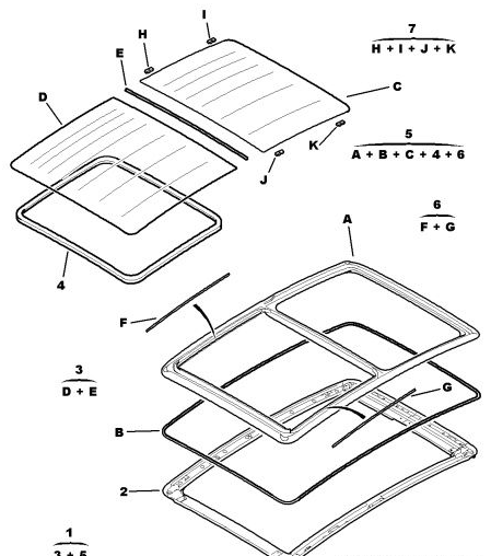

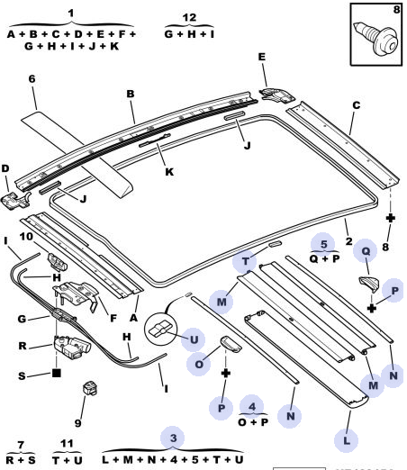

Re: Xsara Picasso Electric Sunroof.....
Not sure what you are looking for, but here are the parts diagrams in case it helps you work put what's what:
No, not from either the manual or the documentation I have.
The system does have an antipinch function that needs reinitialising if the battery has been disconnected.
There should be 2 settings - 1 quick press to the comfort position, second quick press - to maximum opening. To reinitialise, after roof has closed, hold button in the closed position for a second or two and release.
But if the glass is not opening or closing, then it's possible the drive cables have snapped :cry:
Replacement is possible, but involves taking the headlining off, the interior blind trim, drilling out the rivets and replacing the cables.....
They do a cable set - item (12) in the second diagram I posted that contains the complete cables at 'G', 'H' & 'I'. Part number 8401TR and the price is £177.07 inc. VAT from Citroen.
If you want to attempt this, let me know and I can put up a guide, but I'll need the VIN as there are several types of roof systems used and I was referring to an Exclusive as an example above.
It may depend on where the wire (s) are broken - if they are broken, as the motor reducer may still retract and spool the wires out - it may be that the break is where you can't see it.
The only other issues I'm aware of is that the runners can get dry and this can cause additional strain on the system - some good silicone spray along the length of the runners will ensure less strain on the motor. So you have nothing to lose I would suggest at this point.
Ok, so confirmed the parts and the previous diagrams I posted are correct. At least I have the VIN in case of future queries.
