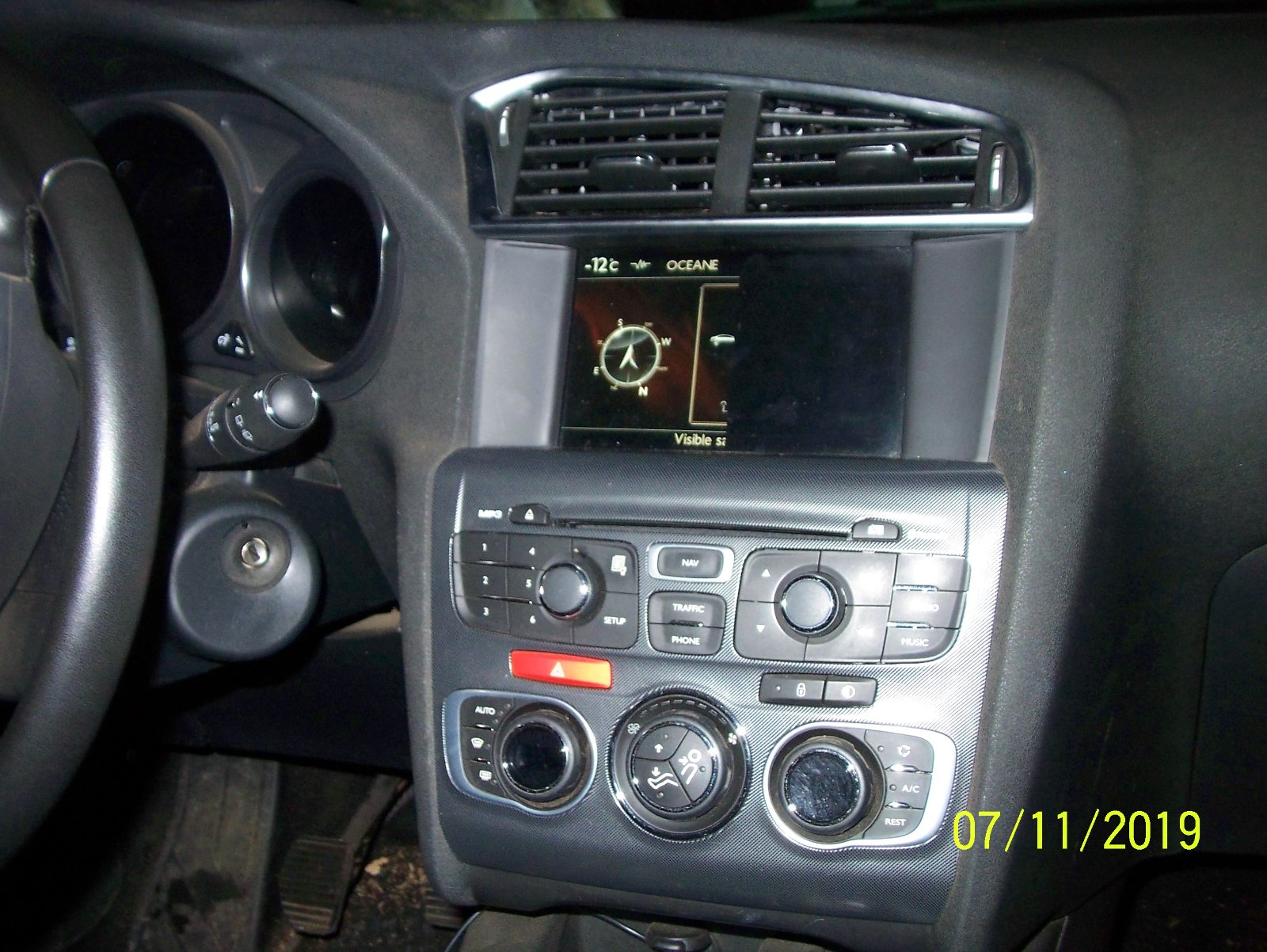

My immediate problem is the LCD Nav. screen of our 2014 C4 Millenium model bought new here. It's not the touch screen version.
A few months ago the screen was covered in coloured vertical; stripes, then kept flashing, then went blank, then info visible under stripes,then worked as normal for about a month. It's now showing the left hand part of the screen 3 times when switched on & then alternates between flashing stripes over information & occasionally almost normal.
Our local Citoen agent says it's the screen & having checked the part number tells us it can be repaiired at a cost of about €500 against about €1,000 for a new screen.
The fact it sometimes worked fine puts doubt in my mind that it's not just a loose connection but I can't find out how to access the screen to check this.
This morning it's just showing the LH half of the info.

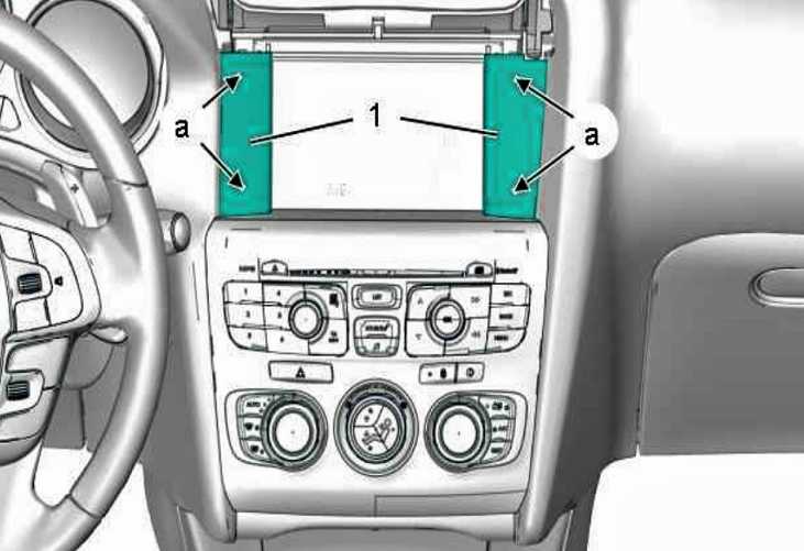

I've been decorating, so catching up on posts today....
Ok, so you'll need a set of trim removal tools (flat bladed plastic or similar)
First follow the instructions here for correct disconnection and later reconnection of the battery and dor correct shutdown and reawakening of the BSI)
BSI Reset / Battery Disconnect / Reconnect Procedure Failure to do this can brick the screen / RT6 Head Unit as the power must be removed before disconnecting the screen!

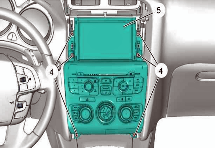

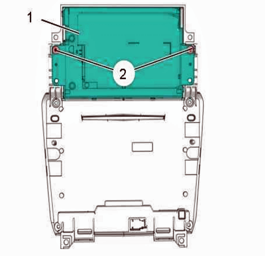

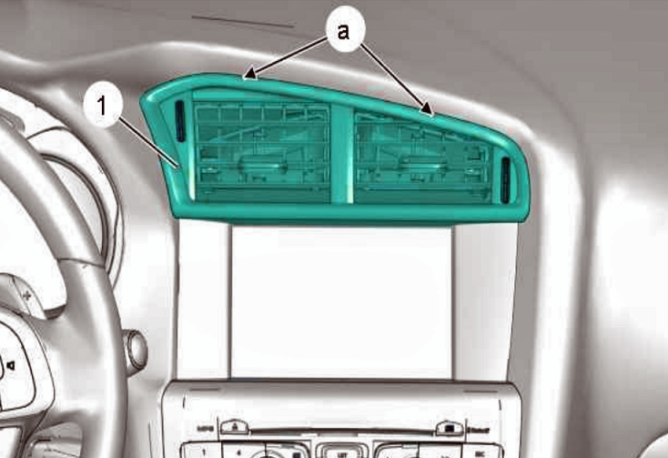

To get to it you'll need to remove the central vent:

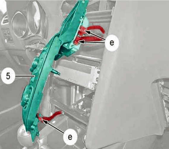

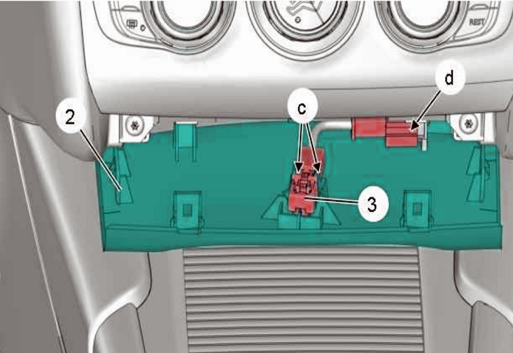

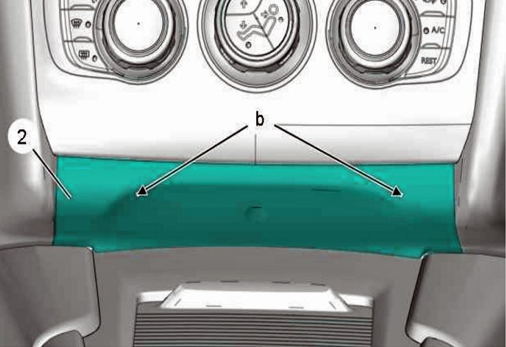

Next you'll need to remove the multiplexed Control Panel:
Refit in reverse and lastly, follow the remainder of the procedure to reconnect the battery. Note: if you have to have the door open to work, then flip the door latch inside the end of the door to fool the BSI into thinking the door is shut. If you don't do this, then the BSI will keep the car networks triggered and prevent the ECUs on the network form going to sleep.
| Unclip the central air vent (1) (at "a") using trim tools. Remove the central vent (1). |
| Detach the embellishers (1) ( as "a") using trim tools.. Remove the finishers (1). | Unclip the trim (2) ( as "b") using trim tools. Release the trim (2). |
| Detach the lamp (3) ( as "c") using trim tools. Disconnect the connector ( as "d"). Remove:
| Remove the bolts (4). Detach: The multifunction control panel (5). |
| Disconnect the connectors ( as "e"). Remove: The multifunction control panel (5) | Remove:
