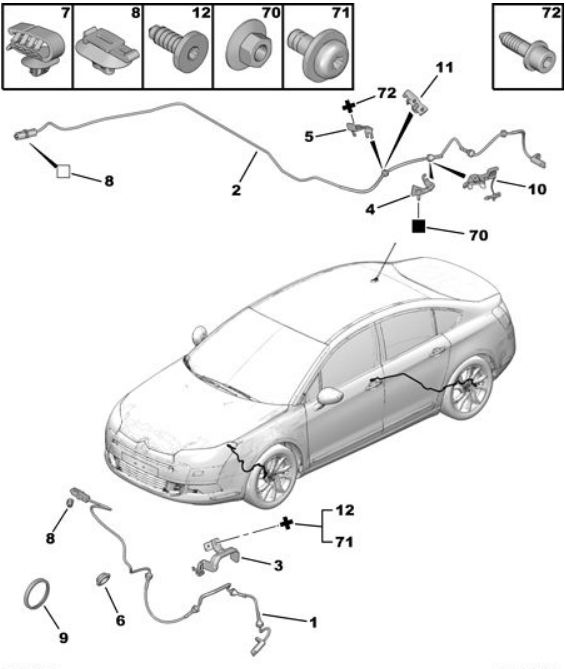

Re: C5 X7 ABS sensor & injector blow past
Part 4545K6 for the front sensor (item (1))
£71.68 from Citroen new inc. VAT.
Thanks again for that Marc. I've managed to buy a genuine Citroen part on Ebay for £25.
