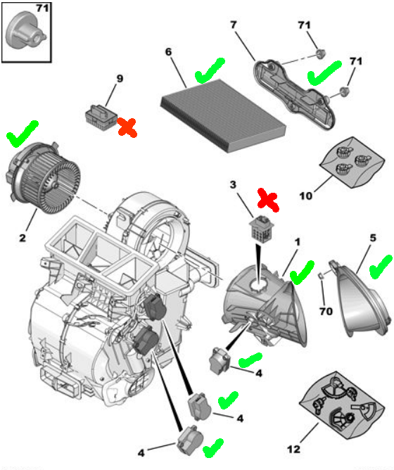

Ok, so first of all I suspect you may have ordered an incorrect part - that your vehicle does not have:
This is not for your vehicle - it has a 5 pin connector.
This is the parts for your Picasso - I have marked on it the parts you do have and those with crosses the ones you don't - as you can see the photo above is part 9 that you don't have.
The resistor you have is the type that is built onto the blower motor itself and is not shown as a separate part by Citroen - although we know you can get these from aftermarket sellers - either the coin type transistors, or you can replace the whole module. But be warned a lot of the cheap jobbies on the market are dead on arrival and do not work! You can order just the transistors, drill out the rivets and solder on the new resistors.
There's a full video on doing the job here:
So I wouldn't worry about the wiring at the moment - I suspect it is the transistors as there is not a separate blower control motor.
This problem is caused by not changing the pollen filter regularly enough - the road grime, oil, dead bugs and other crud builds up and restricts the air flow, which causes overheating and eventual failure.
I've had PSA cars all my life and never once had to replace this on any of them - but I do replace all the pollen filters no later than every 2 years as I like to make sure I'm breathing half decent air , such as there is any!

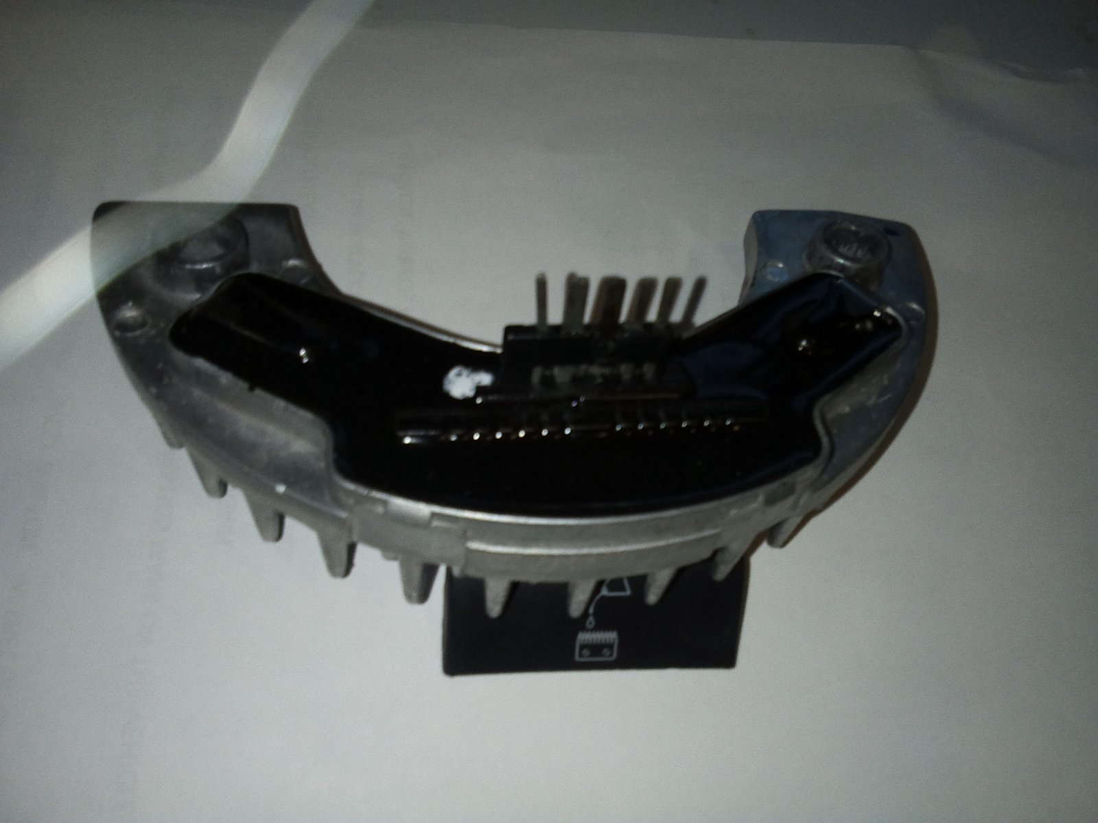

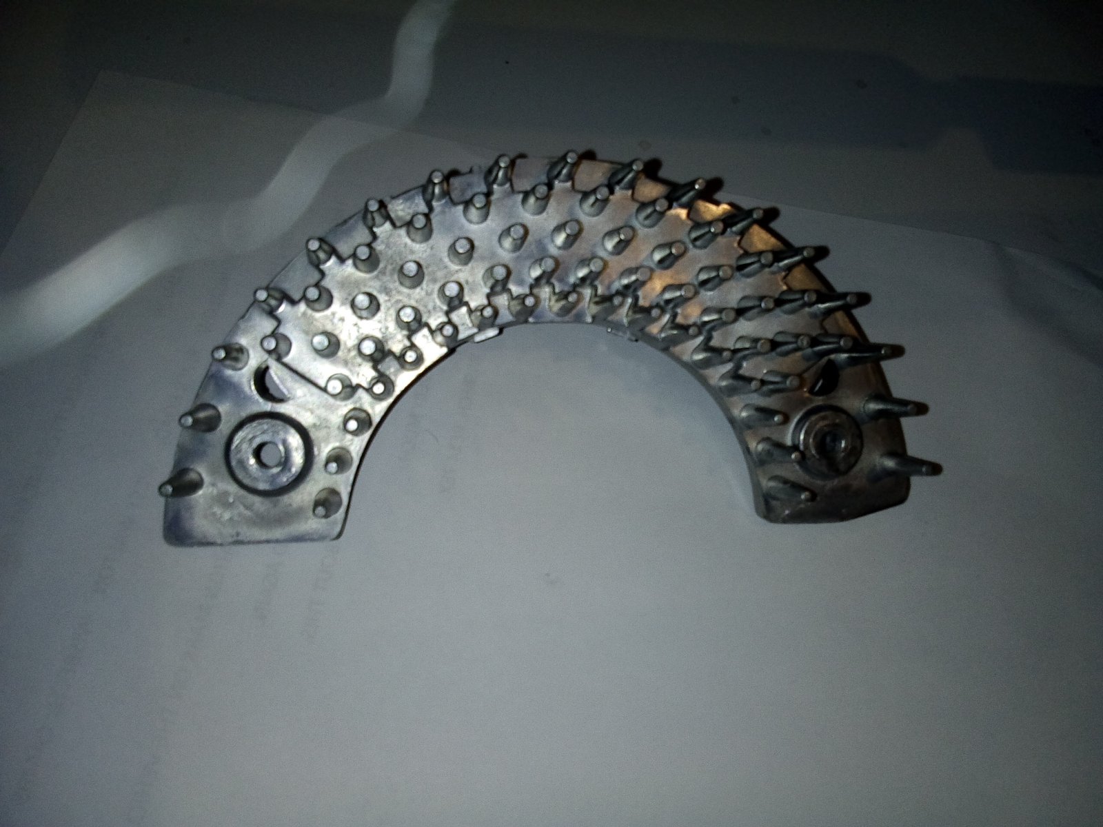

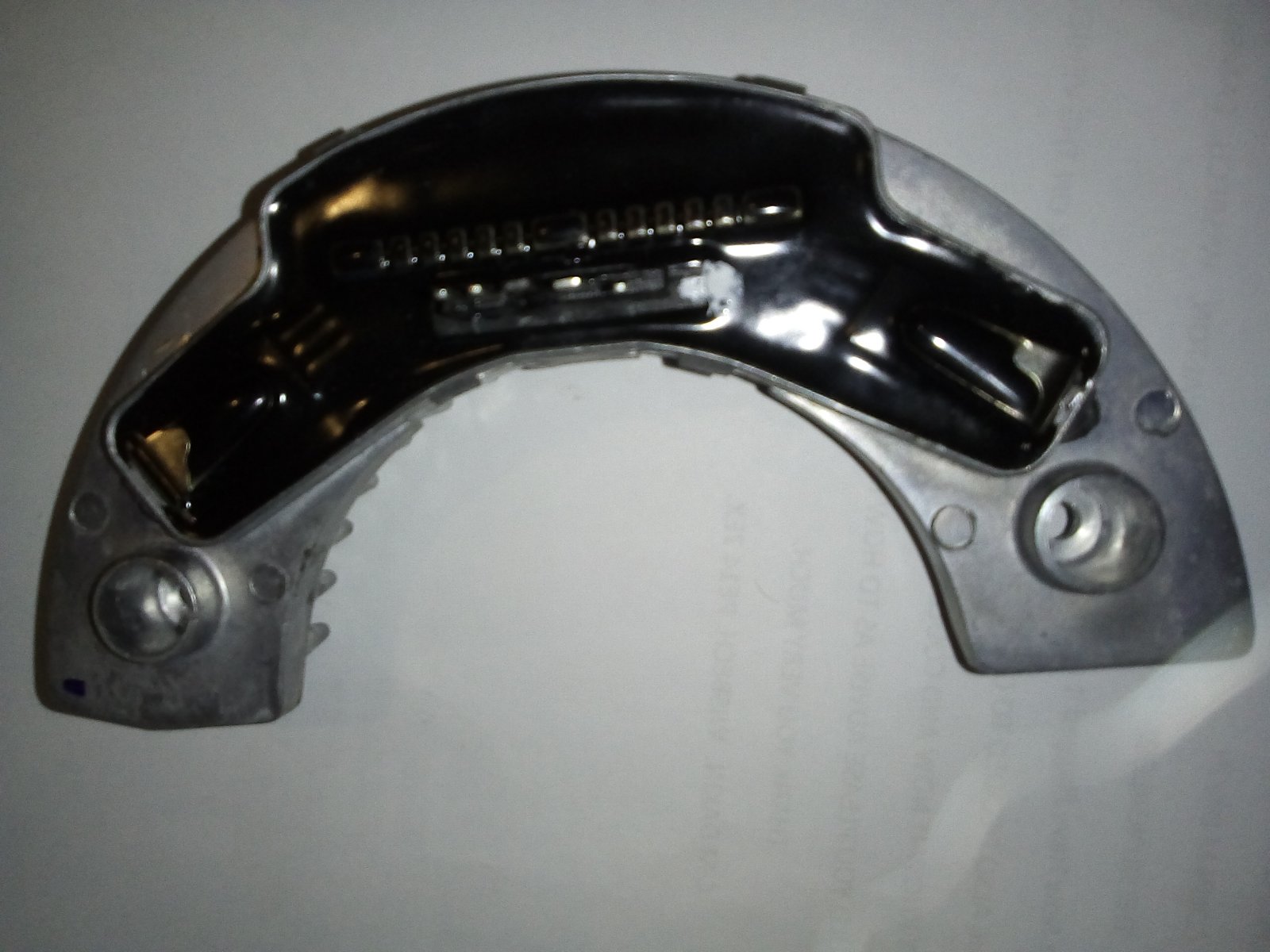

Hi this is the Blower motor in mine, ok it is a 206 as stated above but can see the same motor and two connections, Time to View 2min 58.
The Large Resistor is behind the plastic cover at the top of Blower Motor.
2 screws hold it in place,it is Twice the Size of the one shown on the video Marc.
Colin.
Colin.
