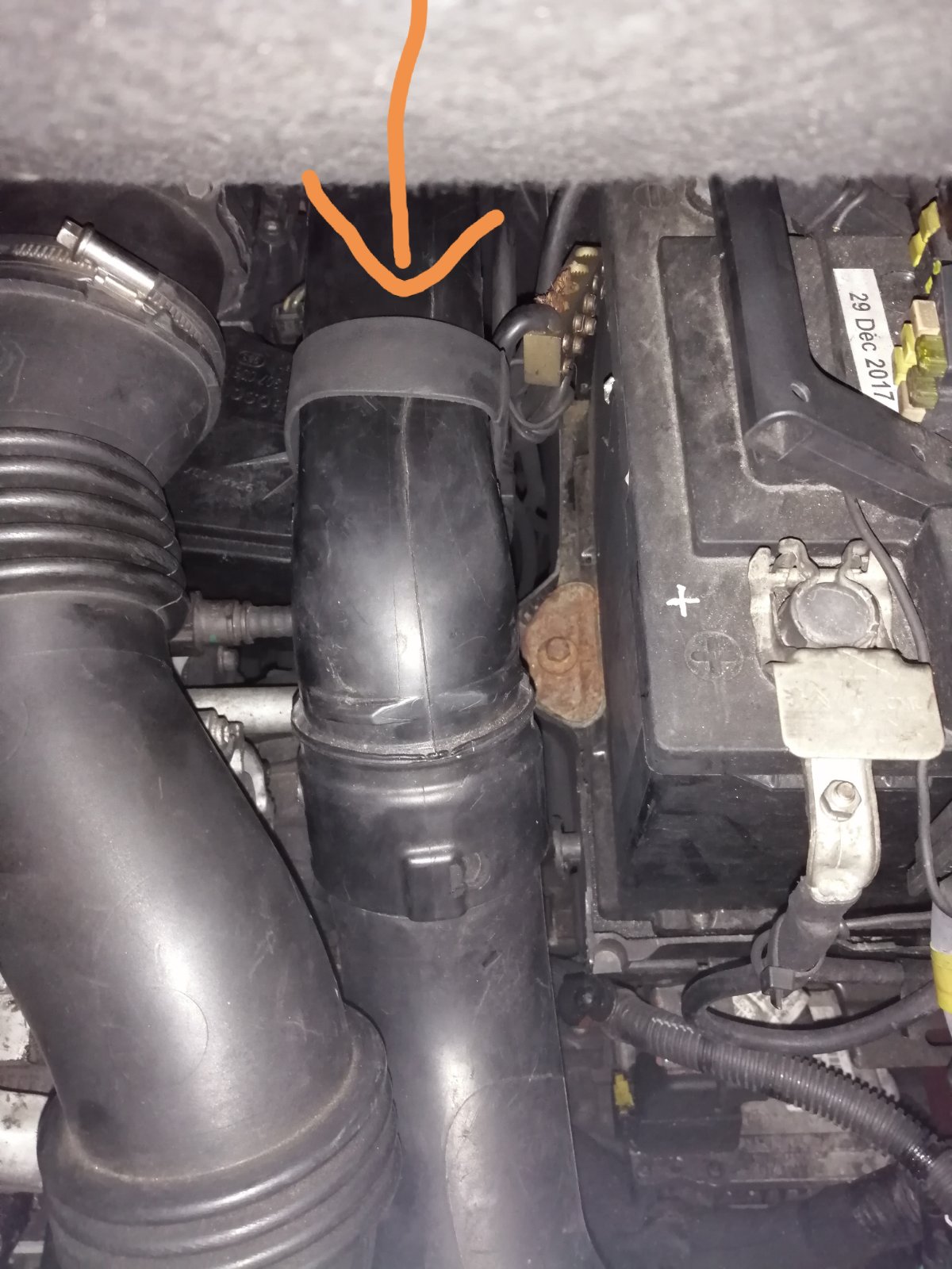

This plastic pipe keeps popping off at the back, possibly the pipe it joins onto is damaged, can anyone tell me what it's called? There was a rubber band which I've slide up to photo, I assume this isn't normal / standard?

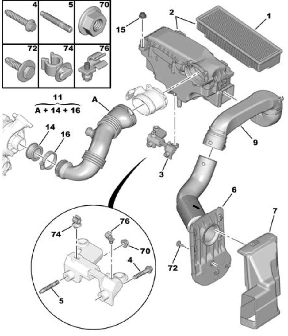

It’s an air hose, item 9. Part 1434C1

The rubber band is not original.... It's supposed to be clipped into the air box, and there should be a rubber grommet that fits on a ball on the end of one of the vac pump bolts. It's easy to break the connection to the air box - ours was by the time we got it at 4 years old. I suspect new pipe and box required if you want to fix it, at no doubt £££££!
