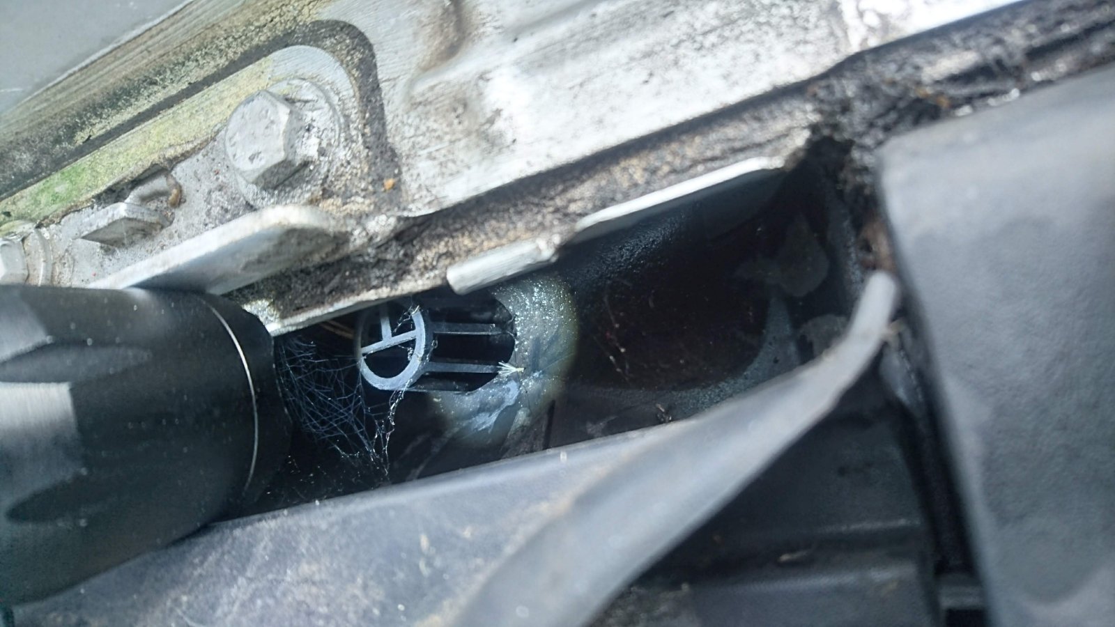

In recent weeks had noticed a bit of damp in front left corner of passenger footwell. There seems to be no odour to it but when touched there is a slight almost sticky feeling on fingers. Panicked at first as I thought it might have been a leak from heater matrix. However, after the deluge yesterday here in Sussex it is much wetter. Confusingly, the sides of the footwell are dry. Have looked at edge of scuttle and can see a drain hole which seems to be clear. see pic.
Any ideas?

The usual thing is the scuttle drains being internally clogged. Carefully pour some water in the drains and see if it exits in the wheel arches, most likely one side will but the side where you have water in the car wont, then clear the offending drain.
When I wash my cars I always flush the drains out to keep them clear - I park under a tree that dumps inordinate amounts of rubbish on my car and lots of it makes its way into the scuttle drains.
Seems to work as the list time I had to clear them was on a GS in 1985. Easy when I discovered how to do it but no fun being deluged with a load of stinky filthy water I wasn't expecting.

Worth checking the seal on the windscreen scuttle plastic trim. If its not flat tight to the screen that might be your problem as rainwater gets forced under it if its not a good fit..
I had a similar problem on a 307. Went down the avenue of cleaning out all the drain channels to no effect. I'd had the windscreen changed on the car in France & the sloppy fitter had distorted the scuttle trim so it would not sit flat to the screen. £154 from PSA!
A rescued scuttle trim from a breakers for £5, fitted & problem resolved.
