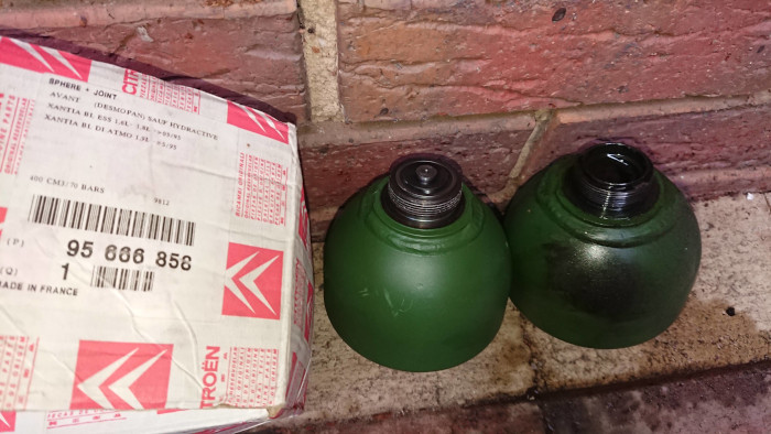

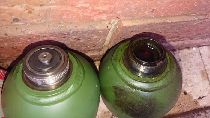

So I've taken the sphere off, and found the inside of it is different to the one I intend to replace it with. It was listed on eBay as an accumulator sphere: https://www.ebay.co.uk/itm/273678578484
The one on the left is the one I bought, the right is what came off the car:
Does this matter?

That is not an accumulator sphere, from the number and description on the box, it appears to be a front suspension sphere for a Xantia without hydractive suspension.
Don't fit it as an accumulator sphere, as the damper elements will prevent proper operation.

I'm not so sure about that. An anti-sink sphere while having no damper valve only has a 3.5mm pipe union hole, so the flow diameter is very small.
Probably OK in an emergency but I would not recommend it otherwise as it is still probably going to cause hammering of the pump and supply pipe from the pump to the pressure regulator. (Although not as bad as a completely punctured accumulator sphere to be fair!)

You can also use Hydractive centre spheres interchangeably with the Accumulator sphere; neither has a damper insert, and both have the large 6mm hole. 62bar for the Acc sphere.

Hydractive centre spheres would indeed work well for a temporary accumulator sphere. Front ones are 70 bars (or 75 bars for the smaller 450cc ones) and 50 bars for the rear ones - all close enough to 62 bars that you wouldn't notice a difference.
