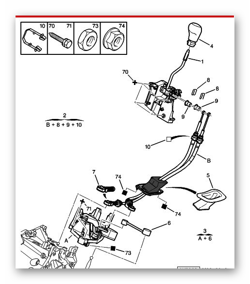

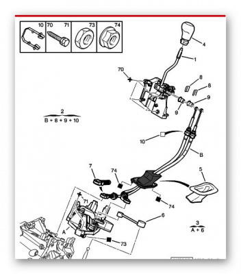

I wish I could Alasdair but I'd need to know which exact car it is on and maybe some pics of the other end of the linkage.
x 2941
Re: Stuck in second gear
If it's this beast I'd first be looking to see if the outer cable has become detached from the clinched end and is moving in and out instead of moving the gear.

It's a Xsara Picasso, if that's any help.. I'd imagine the linkages are all the same on the pre 2006 ones.
