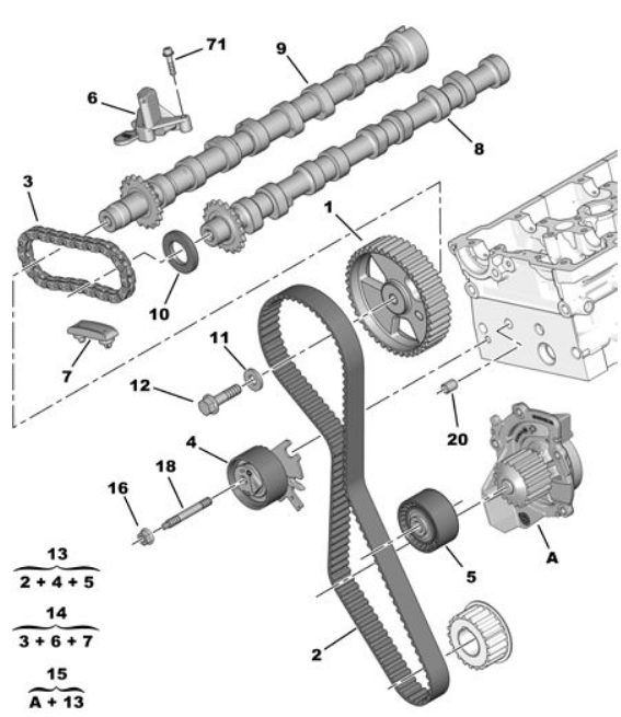

So my suggestions are are the ancillary drive belt - with the engine idling and bonnet up, go and have a listen to see if you can hear the intermittent noise - bearing in mind the transmission to the interior will be dampened a little.
You may have some squeaking in the pulleys - when was the timing belt last changed? - and if it was done, do you know of the full timing belt service was done with the tensioner rollers, water pump etc?
Admin Update (Updated - timing kit for DW10CTED4 engine in light of VIN)
The rollers are at 4, and 5 and water pump at A
When I had mine done the few squeaks disappeared - but mine were not really load - I just had the full kit done anyway.

I don't know what variant of X7 you have (a VIN would help), but here's an example of a timing belt kit on a DW10BTED4 engine:

As I know the timing belt was not changed yet, I planned to do it now. Do you think is this noise related to it? (like the tensioner rollers)

Ok, got that Tom - I've updated the timing diagram in my last post in light of your VIN for the DW10CTED4 engine and deleted the VIS from you last post.
