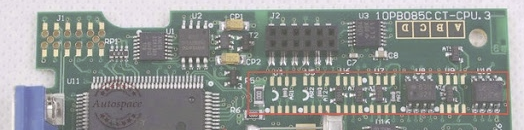

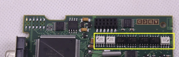

There's no such thing as an "opto-chipset" James.....
I think he's referring to Optocouplers which are used to extensively in a full chip kit to isolate signals between higher and lower electrical sources (like input and output) using light. A lot of these will be missing in a non-full chip kit:
But that's not all, there are other components like resistors that are missing that can also affect CAN communication.
| Here you can see what the Octocouplers in yellow | Here they are missing! |
