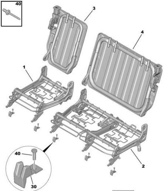

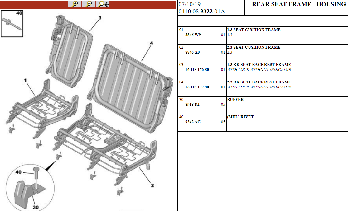

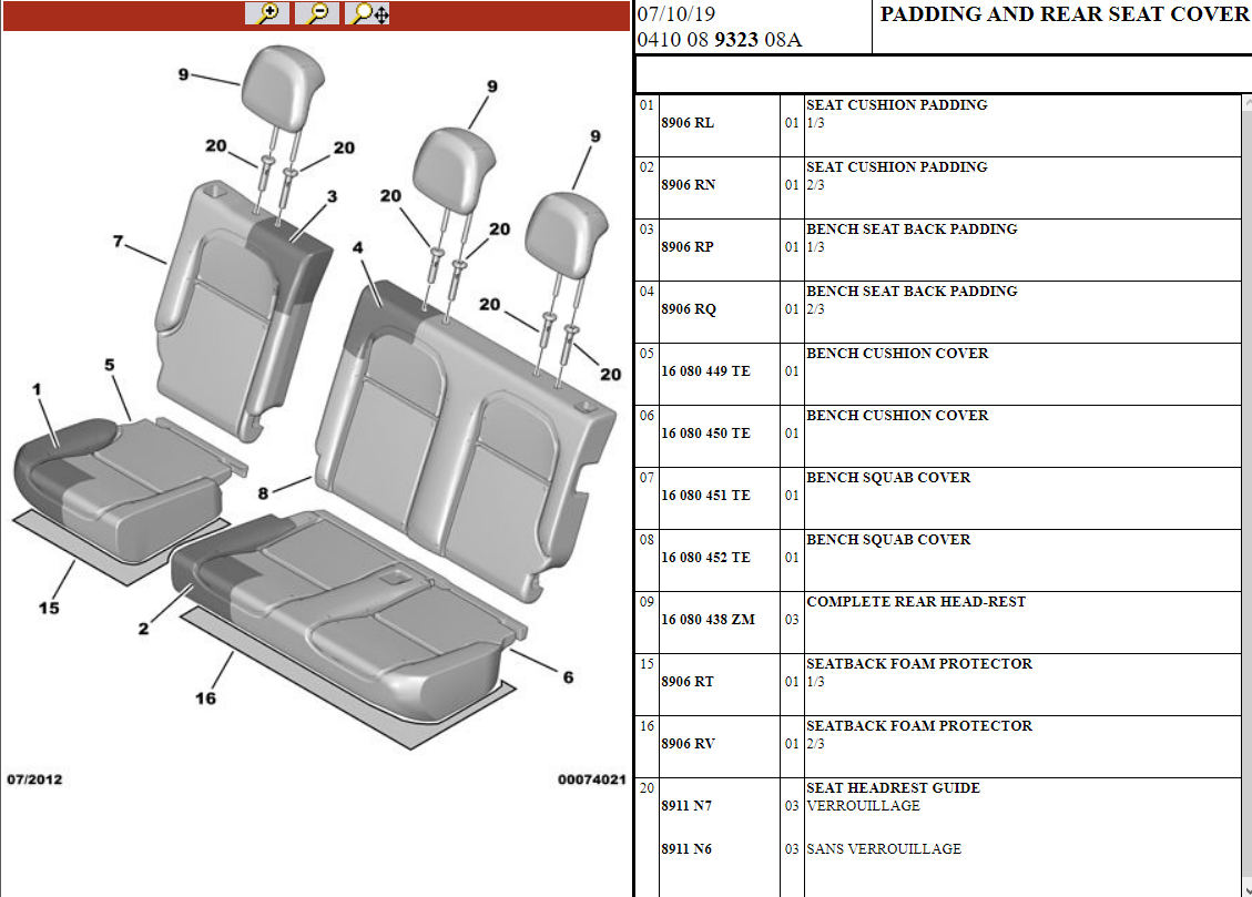

The only way to search is from the part numbers, so on that basis here are the parts diagrams for the seat Frames and the seat pads. You'll need to click on these to magnify them up to see the part numbers:
| Seat Frame Parts | Seat Pads / Cushions |
- x 6945
Re: Back seats
So here is a supplier that has a set and it appears that these include the frames (check out the additional photos and you can see the collapsed seat has the rear back frame) - so it's a good bet these are ready to install -you'll just need the fixings.
The common part to search on for the seats is 8846X0 (digit 0).
