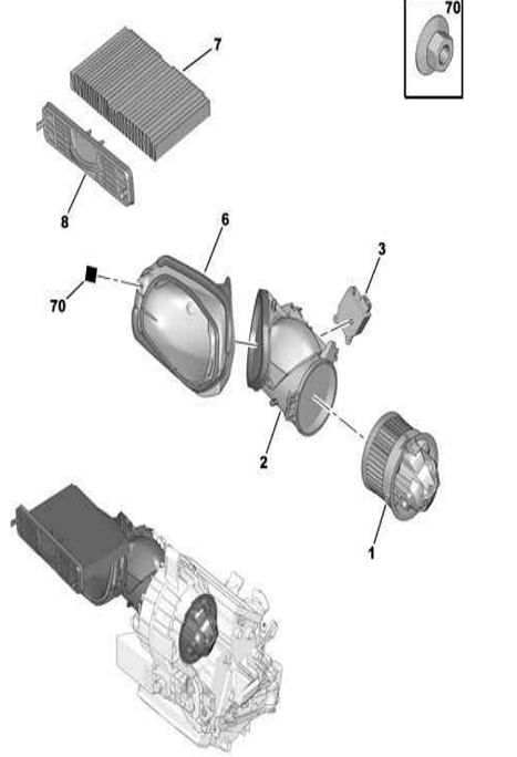

Can anyone tell me where to find the blower motor on a
2011 ds4 ?

It's behind the central console and it a job to remove - it that is your intention. Item (1)

all sorted... it was a burnt out earth wire ...thanks for your help again.
