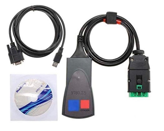

Are you using a proper Actia VCI clone with Diagbox, or are you using a Diagbox on a laptop without the VCI? A photo of your diagnostic equipment would help if you are not sure.

Im using a clone on my laptop with just the cables on the picture. Also I’ve attached the VIN too.
