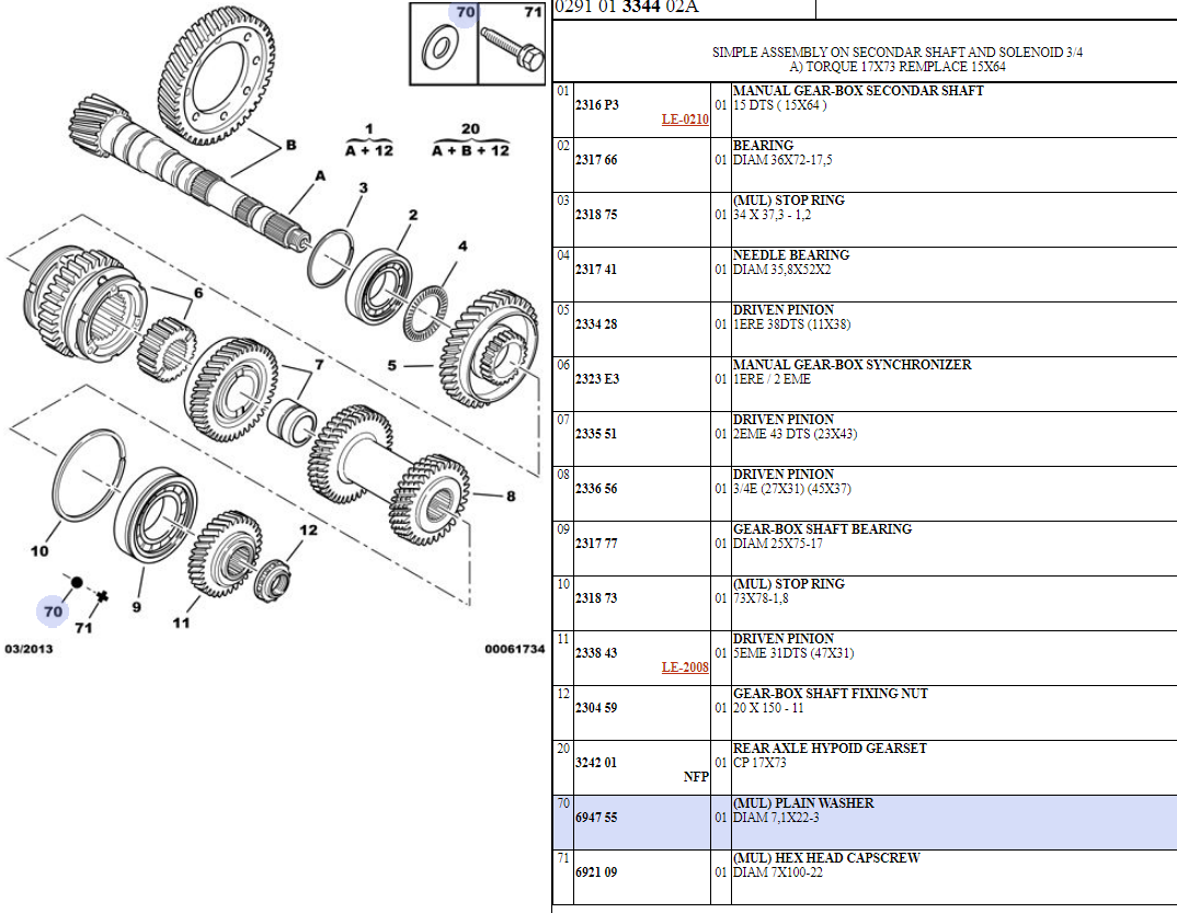

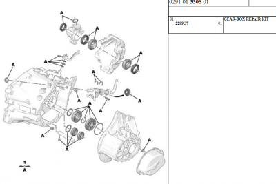

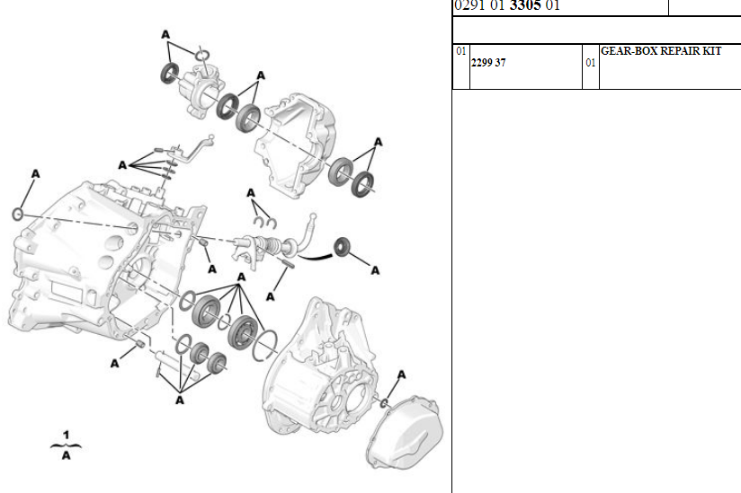

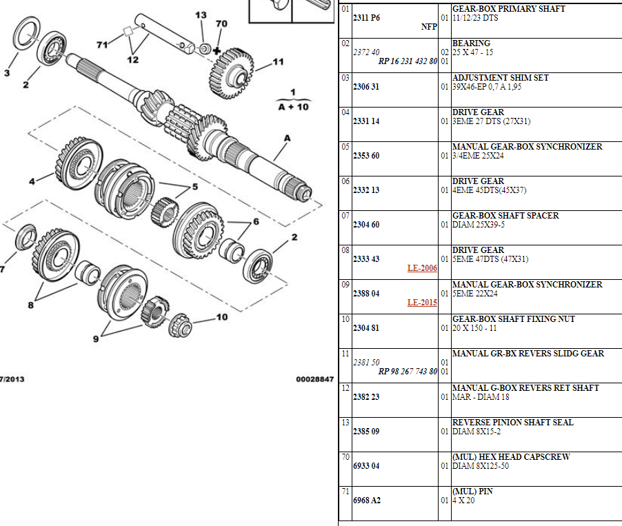

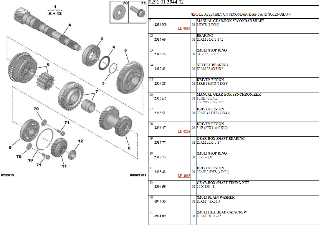

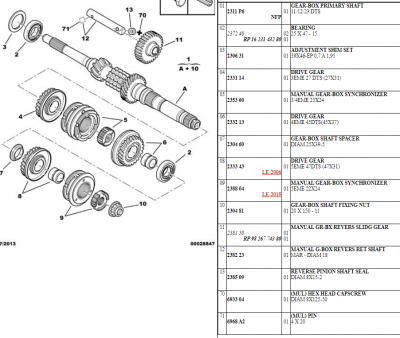

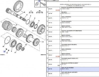

Re: Xantia - 5th gear problem
I don't know quite what you are after, but these are what I can see.
If you can specify Table A, B, C or D and then the part reference on the diagram, I can give you the corresponding part numbers.
Click the images to zoom
| (A) FIRST LINE MANUAL GEAR BOX | (B) REPAIR KIT MANUAL GEARBOX |
| (C) SECOND LINE MANUAL GEAR BOX A | (D) SECOND LINE MANUAL GEAR BOX B |
- Posts: 12599
- x 1490
8,9,10 box A and 11 and 12 Box C Marc.... £255 from Citroen, less than I thought! However, these are widely used, so a 2nd hand set is a distinct possibility, if you can find one in a scrap yard - there might be differences in the number of teeth, but you should be able to find a matched set off a diesel which will give a similar ratio. Jim's website (http://www.eastment.net/BE3%20Gearbox%20Strip.htm) explains how to get it apart - the 5th gear is under the end cover, and can be got at with the box in situ.
