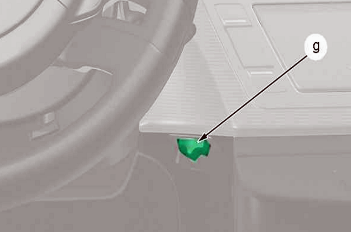

I'll need your VIN to check the system you have and options, but generally the ambient lighting on this model has 2 functions:igracanac wrote: 18 Oct 2019, 09:37 First sorry for my bad english. I have citroen c4 gp exlusive. There is ambience light interior pack, the orange led light at the roof, under the board,on the doors. But it only working when i stop the car and open the door. It cant work when i driving. Is there problem and can i do something to check on lexia or diagbox.
Night Time Driving
Vehicle Location Function (with Fob) - which is part of the welcome function.
So the welcome lighting works when the doors are opened, (as you say) or when loating the vehicle at night using the fob.
When driving at night the ambient lighting level can be controlled or turned off - so you need to check the rheostat switch shown below in the picture. Holding it one way or the other (rocker switch) will turn it up or down, so make sure it has not been turned off completely, as the lighting level is memorised once you let go of the switch!
igracanac
- Posts: 6
- Joined: 18 Oct 2019, 09:29
Re: Ambilight
I do that while i driving but nothing happening with the light.

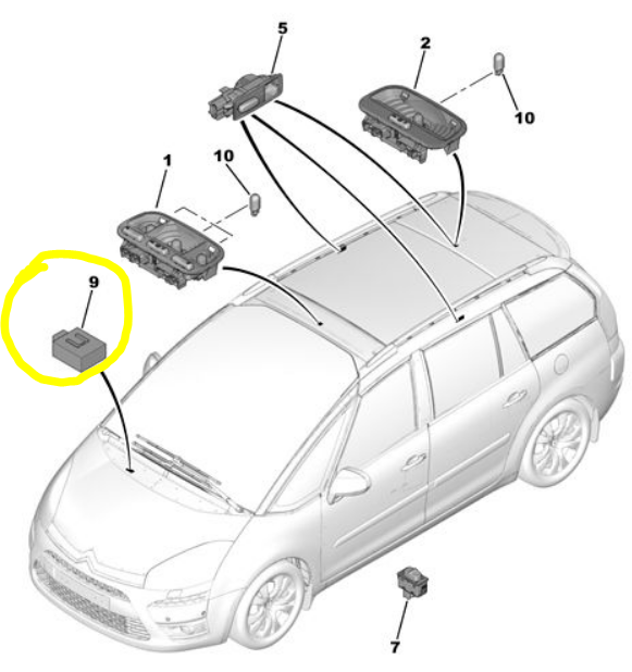

It's possible the interior lighting unit has a fault - or there could be a wiring fault.
It' item 9 highlighted below:
Part 6554VK for reference. It's located behind the passenger dash
Some info:
The purpose of the interior lighting electronic control unit (light pack) is to control the lamps dedicated to the night-time ambient lighting and the welcome lighting:
Below the dashboard on the driver’s side and on the passenger’s side
Some info:
- On the dashboard
- The door inserts
- The roof
- 2 storage trays
- 2 reading lamps on the back of the front seats
- 2 rear map reading lamps
- 2 upper storage compartment lamps
igracanac
- Posts: 6
Re: Ambilight
On the roof item 1 there is one orange lamp ,that litle lamp is lighting when is dark. I dont no what is purpose of that ?
- x 6946
Re: Ambilight
That is part of the ambiance lighting.
According to version, the interior lighting electronic control unit (light pack) permits dual-function lighting (Night-time ambient lighting/welcome lighting) using the following components:
- 2 Interior door lamps: Driver’s and passenger’s
- 1 roof lamp
- 4 interior opening control lamps: Driver, passenger, rear left and rear right
- 1 below-dashboard lighting: Driver’s and passenger’s (Footwell)
- 1 indirect lighting on the dashboard
- 2 storage tray lamps : Driver’s and passenger’s (With lighting as a hand approaches)
- 2 reading lamps on the back of the seats: Driver’s and passenger’s
- 2 upper storage compartment lamps: Driver’s and passenger’s
