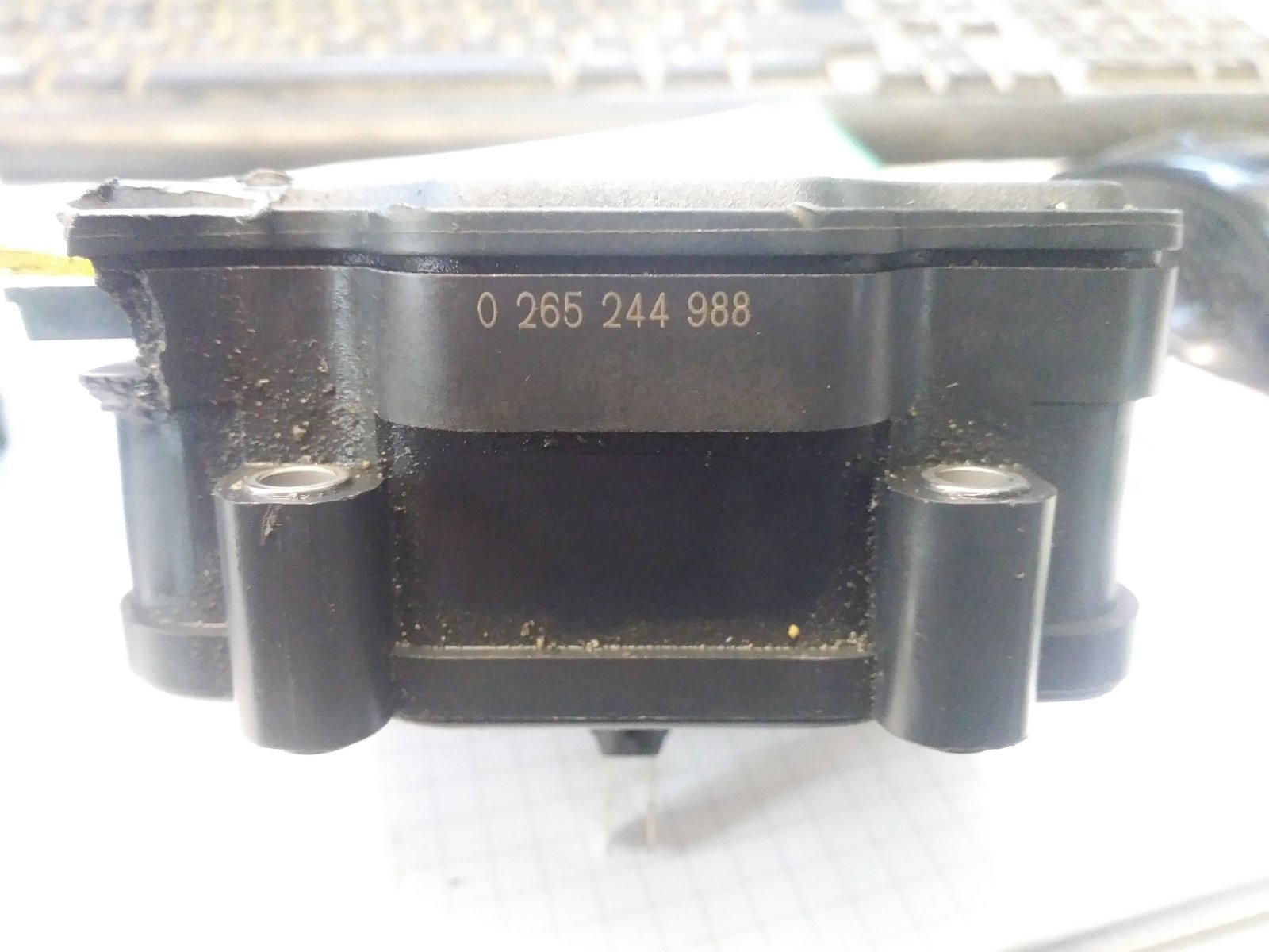

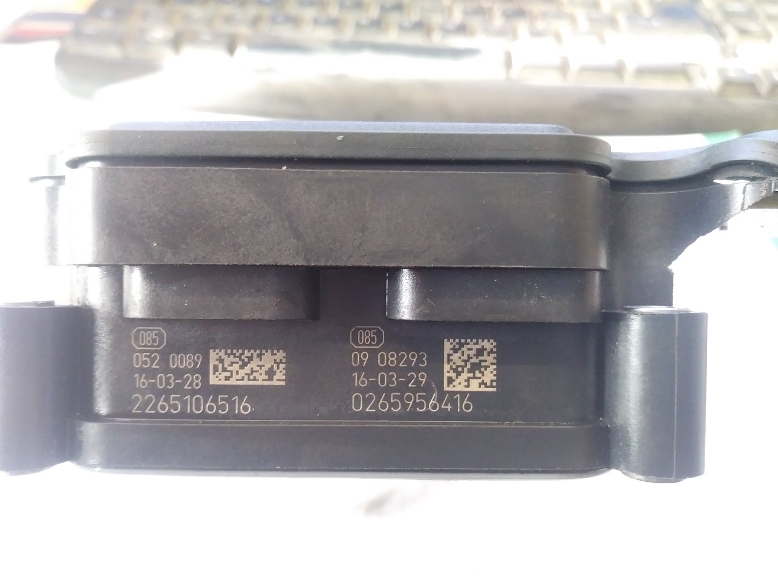

I have 98 111 483 80 on the valve block which seems to be undamaged . If I can find a matching serial number block would I be guaranteed that the ECU would be compatible ?
Provided I can find a 4541JC/4541SN BOSCH ESP 9.0 would that work (presumably only the software can be changed by PP2000 so the firmware version would have to be identical ? )
I took a photo of my ecu - I can only find a matching ecu on Polish websites. I presume Citroen dealers would want an arm and both legs even if they sell the ecu separately..
Sorry about so asking so many questions !

Thanks for the link Sir Marc, the later pumps seem scarce. What is the 0265 258 366 number?..on my ecu in the same place I have 0 265 244 988 ?
The seller says the numbers for the software and firmware versions are the same as on mine :)
x 6947
Re: Accident damaged Berlingo abs fault
Those are likely to be software / firmware levels. You can't update the these with a Lexia, as you will need access to PSA servers and that will deactivate your Lexia clone. But they units can be coded to the vehicle if needed. I can't tell you exactly what information you need - but if you have Lexia / Diagbox and can currently communicate with the ABS ECU, then I would go into the module and take a screenshot of the current parameters in case the ones from the second hand replacement are different.
