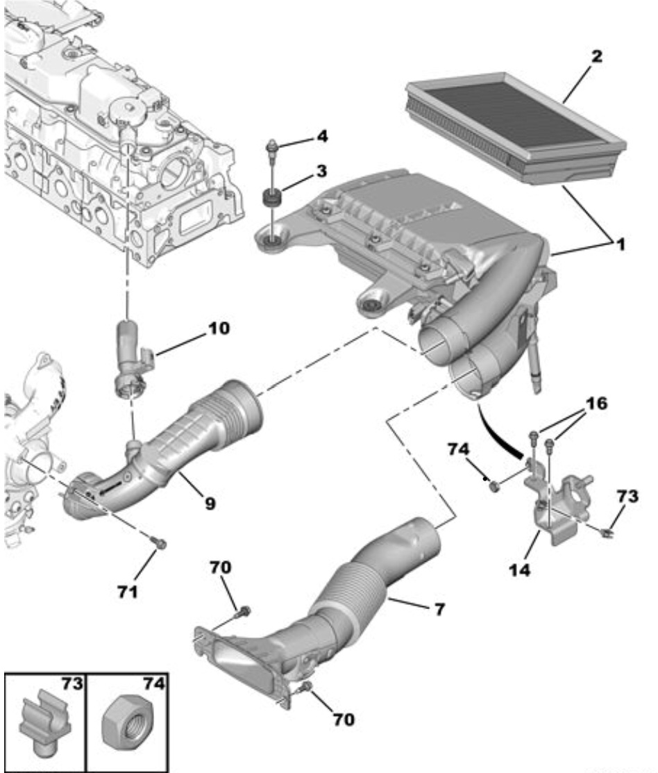

Can any one tell me what number 10 in this parts diagram is please . :)

It looks like a heating element that warms up the crankcase fumes in cold weather to stop the water vapour from condensing before it gets to the turbo.

It's officially called a Housing Gas Resuction pipe, variants for engines with and without heater gas circuits.
It would be easier if we try this the other way round. If it's for a car you own, then pop up the VIN so we can obtain the correct part number - there are lots of these for different models and engines.

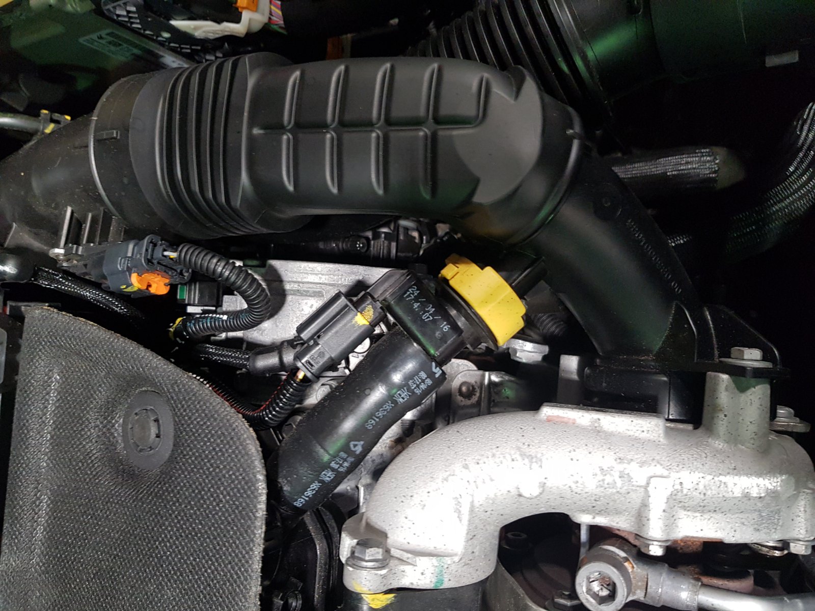

That part

Right, here you go, this is from your VIN that Steve sent me.
(9) is the air hose
(10) Housing, Gas re-suction pipe part number 9677815380

Thank you , any ideas what it actually does

xantia_v6 wrote: 14 Oct 2019, 18:44 It warms up the crankcase fumes in cold weather to stop the water vapour from condensing before it gets to the turbo.
