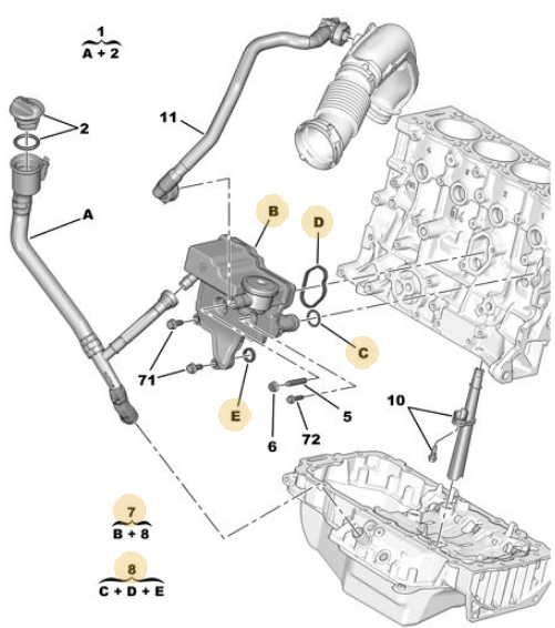

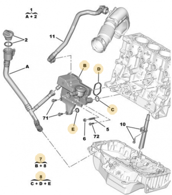

There is no PCV system on diesels, but there is an 'oil vapour strainer' system on your C5: The item highlighted 'B'.

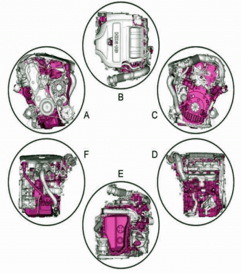

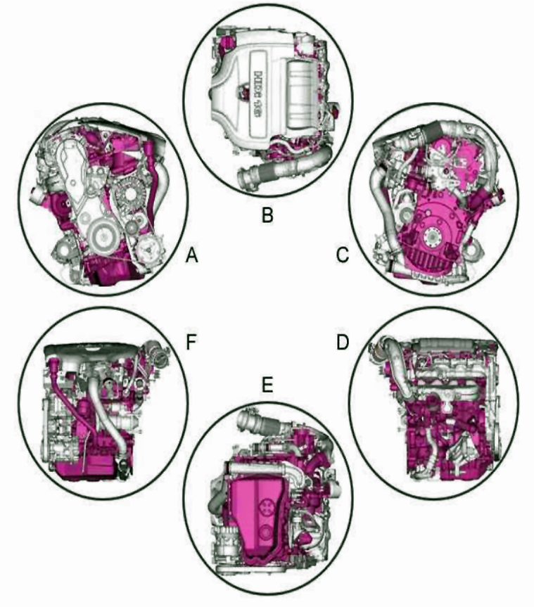

If you suspect an oil leak, having some idea of the source of the leak would be helpful in tracking it down.
Which area from the following?:
