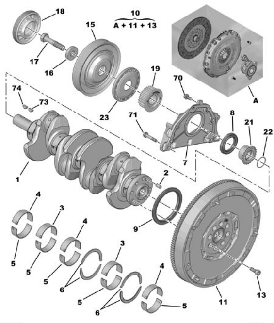

Re: 2015 Grand c4 picasso 2.0 bluehdi dual mass flywheel clutch kit failed at 30k miles HELP
So the correct Dual mass Flywheel is part number: 9808378880 (new) or 1649616080 for an reconditioned one. Item (11) below.
They are £553 and £522 inc. VAT repsectively from Citroen,
You can pick up decent branded (Valeo, Sachs) for about the £400 mark.
https://www.ebay.co.uk/itm/Flywheel-Clu ... 3889271951
The thing to remember is that there are hundreds of these things out there and they are designed for a specific transmission fitting / engine / torque etc., etc., so important you get the correct part number or you will end up with problems and wasting money. With these part numbers, you can search for an aftermarket solution.
