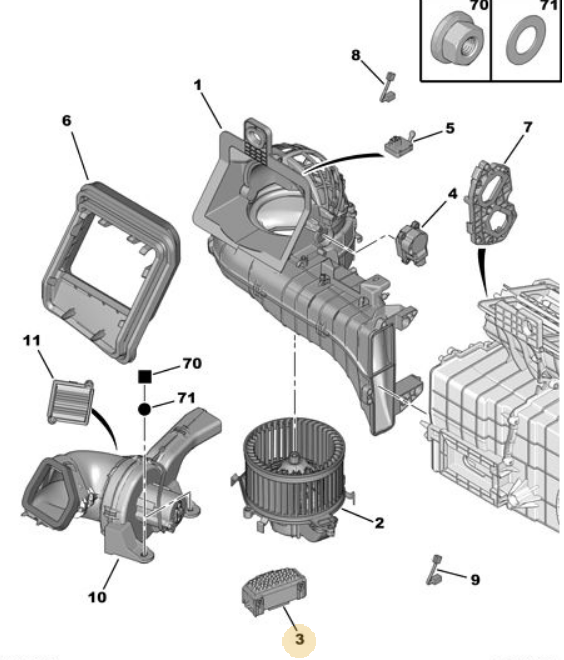

Re: Citroen C4 gran picasso blower not working
Ok, so you can see item (3) is the blower motor control unit resistor. It is part 6441CE and the power will go via this unit to the motor itself.
So if there is power to the resistor unit but not the fan, then it's likely this is your suspect.
A genuine one from Citroen is £227.62 inc. VAT. There are aftermarket ones from £20 - but be aware a lot of these are of inferior quality and cheap rubbish.
There's a genuine Citroen one here from Eurocarcare for £116.40 inc. VAT:
https://www.eurocarcare.net/heater-cont ... -unit.html
So I ran a fluke multi meter down all the cable from the control panel to the blower, turned out that the smaller connector had become damaged due to water ingress. So I replace the wire and connector, hey presto, one working blower!! Cheers for all the help!
