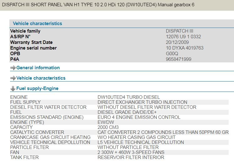

Re: Citroen despatch 1.9 diesel fuel issue?
The VIN produces this engine and fuel detail:
