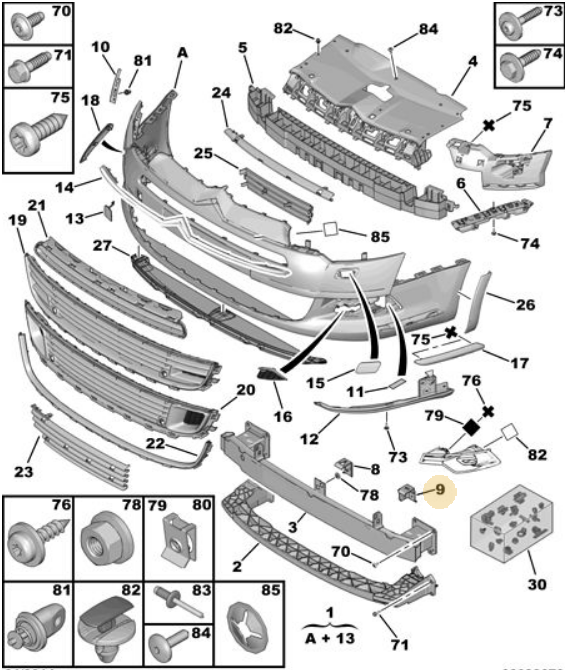

I'm attempting to remove the front bumper in order to deal with a headlamp unit with water within & have found that someone has replaced the white plastic turnbuckles that attach the bumper to the wing with captive nuts & bolts. I can remove these I think but I would like to fit the original fittings. Are these available separately & if so does anyone have a part number?

Can you identify the part item you need from the diagram?
If it's 81 (Bumper Fixing Clip), then these are part number: 743712 and are £2.12 each inc. VAT

That certainly seems to be the right part! I've ordered 4 of them & they should be here Monday.
