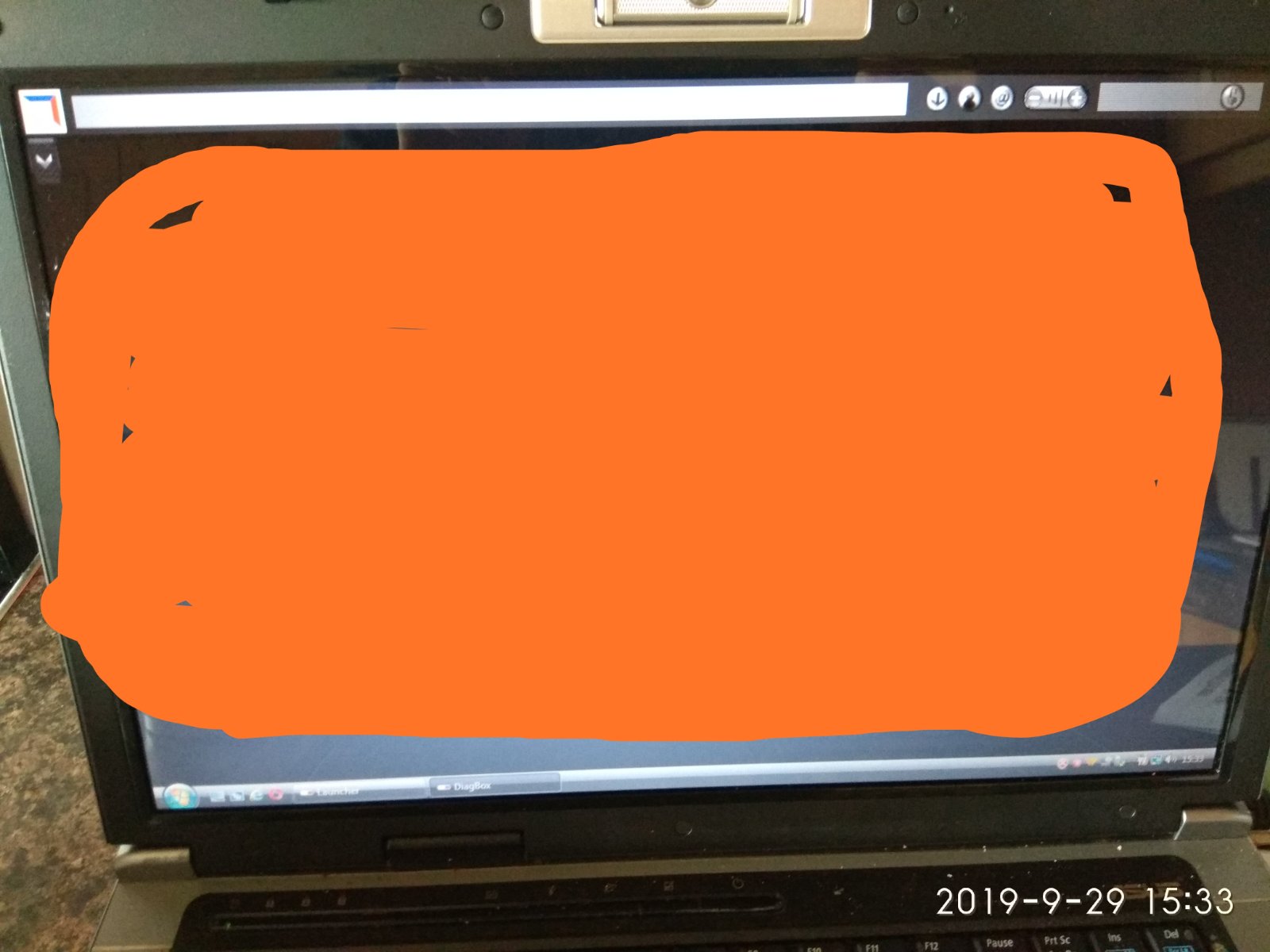

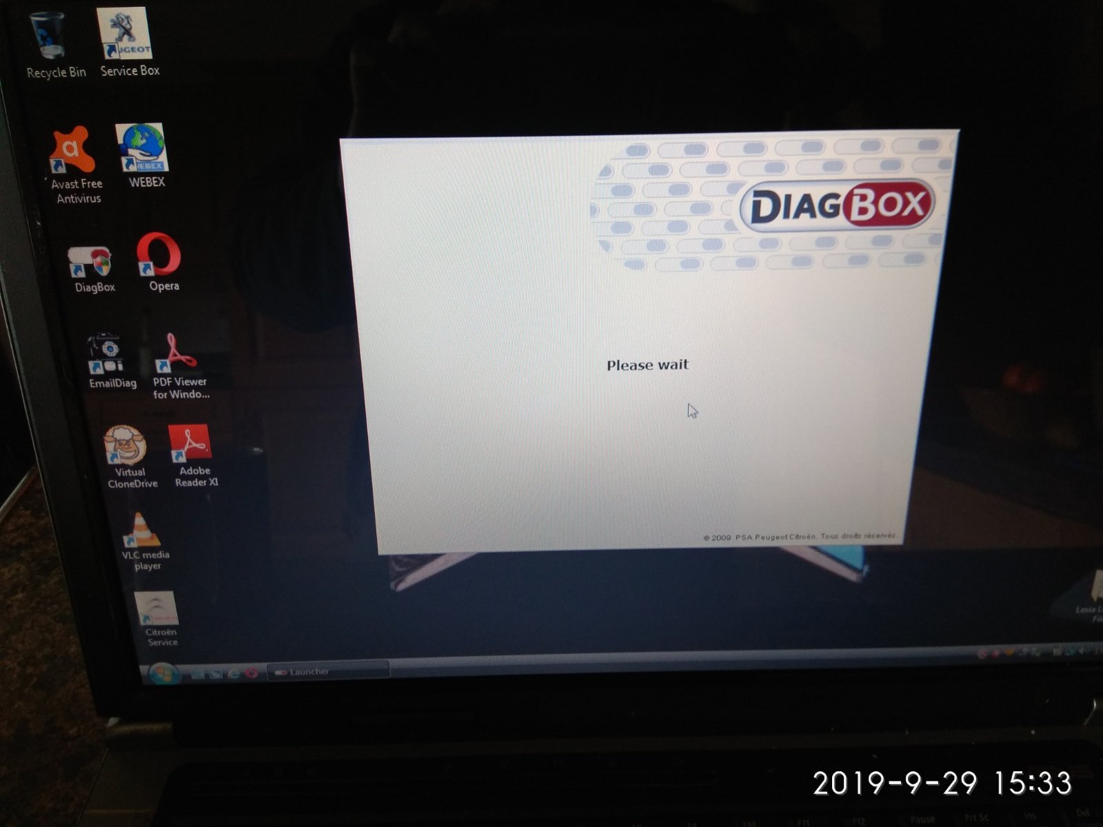

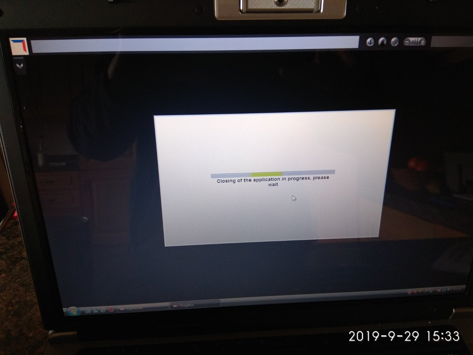

So, I got the kit and instructions at the weekend.
The instructions did not align with the contents, but I managed to get 7.57 installed and validated, or so I thought.
However I don't think the install was successful.
When I open the diagbox shortcut on the desktop it opens to a blank screen and then shuts down.
Before I wipe it all and start again. Is there anything I can do to resolve? I have obtained the licence file.

Not sure what use the second picture is to be honest... but the first thing I can see from your bottom right toolbar is network activity.... You realise you are not supposed to have any active internet connection whilst using it?
Did you make a copy of your licence file once it was initially activated and before installing any updates? If so, disconnect the internet connection, close diagbox, copy the licence file back over, restart the laptop and let us know what happens on launch.

It was screwed before I reconnected.
The second screen is the diagbox app opened. There is nothing in the centre of the screen so it just reflected the room.
The instructions said to have the connections on during install so might have screwed up then.
