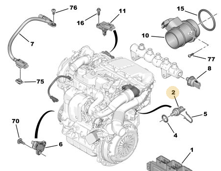

I am suspecting the coolant temperature sensor. Where will I find this for this engine?
x 6955
Re: Problem with juddering 2011 C4 Picasso 1.6Hdi e-110
Unfortunately there are just too many variables - that's the whole point of having engine diagnostics to help narrow down faults. For the price of a couple of dealer diagnostics you could buy your own Lexia clone and a cheap laptop and do it yourself.
As for the water temperature sensor, item 2.
