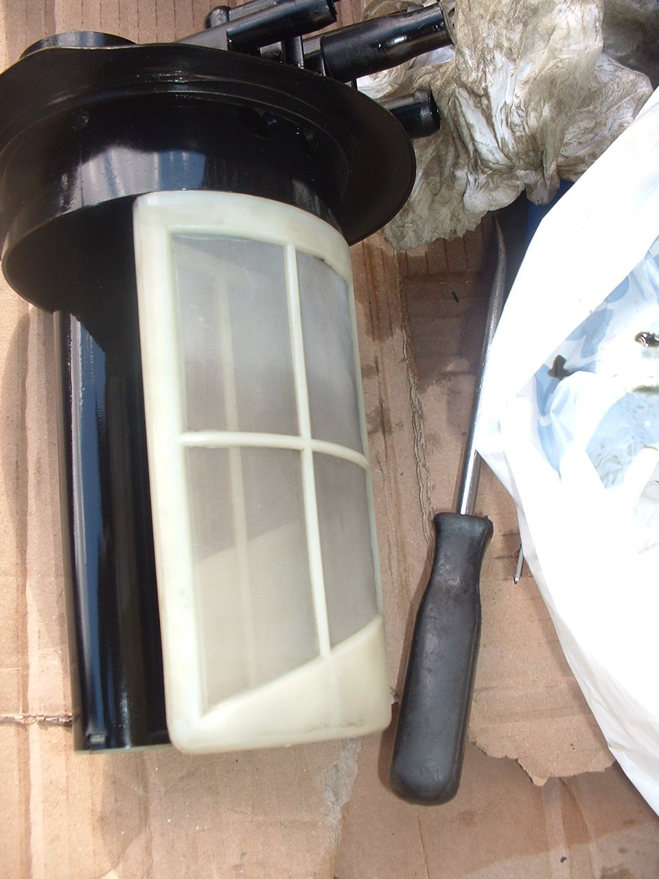

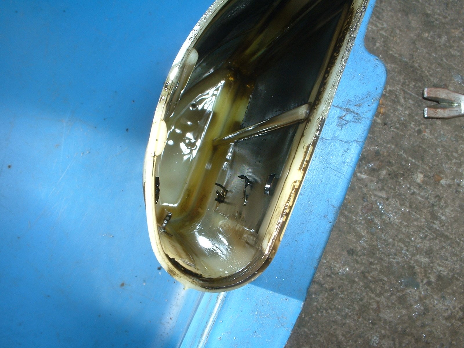

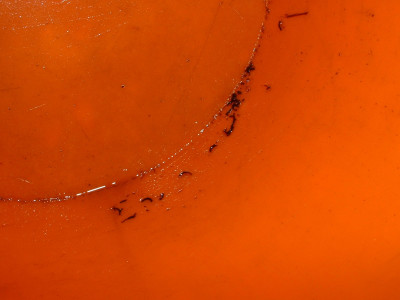

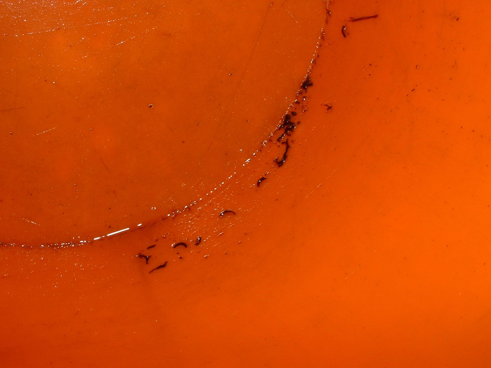

Pumped steering lock to lock to drain steering rack. Emptied my reservoir, pump line and refilled today with 5 Ltr Hydraflush (£26.10) @ 141,250 miles I tried to get the clear fluid to run through all the brake lines but was running low.
My HDi is supposed to have had a flush at 60K but I wonder how thorough they were :?:
Surely these bits of seals should have been removed by now .....

Will follow up tomorrow I'm going to filter it all through the wife's flour sive :roll:

5L is normally enough for one of these systems.
iirc, rear-right brake bleed screw gets fluid through most of the system, except for the other three brake caliper 'dead ends'.
Looks from the photos as if the filters are doing their job of catching big bits.
H'rincage usually works well in dissolving microscopic dirt: goes in clean, and comes out noticeably dirty, if left for the recommended 1500-5000km.
H will shift dirt, but not dissolve rubber particles (or seals!).
Apologies if I have misunderstood.

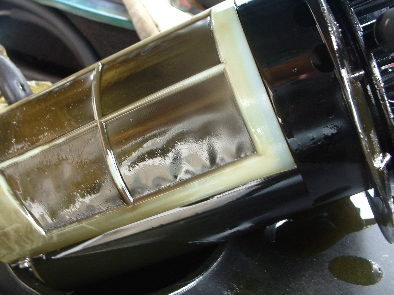

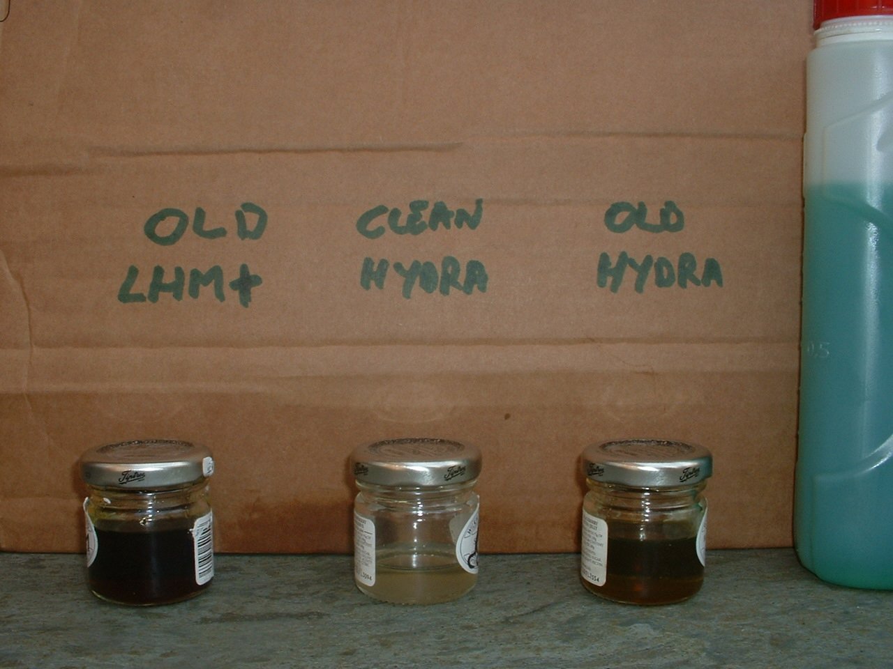

Skull looking at the colour of the LHM clinging to the filters does not seem too bad, a little bit black but more of a yellow hue to it.
When i did my HydraFlush i actually had an easier job of checking the fluid was fresh as can be seen in the Old and New Pics **Edit Old and Fresh LHM not HydraFlush **
I kept the HydraFlush in for just shy of the 5k (km) as i wanted to get a good flush done but as Chris and others pointed out HydraFlush is very good at what it does but does not have the lubrication spec of LHM .
Every time i have done the LHM/HydraFlush change i can concur that one of the rear brakes does produce more air/bubbles when doing the bleeding.
Congrats on the MOT pass, another Xantia lives for another 12 months =D>

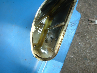

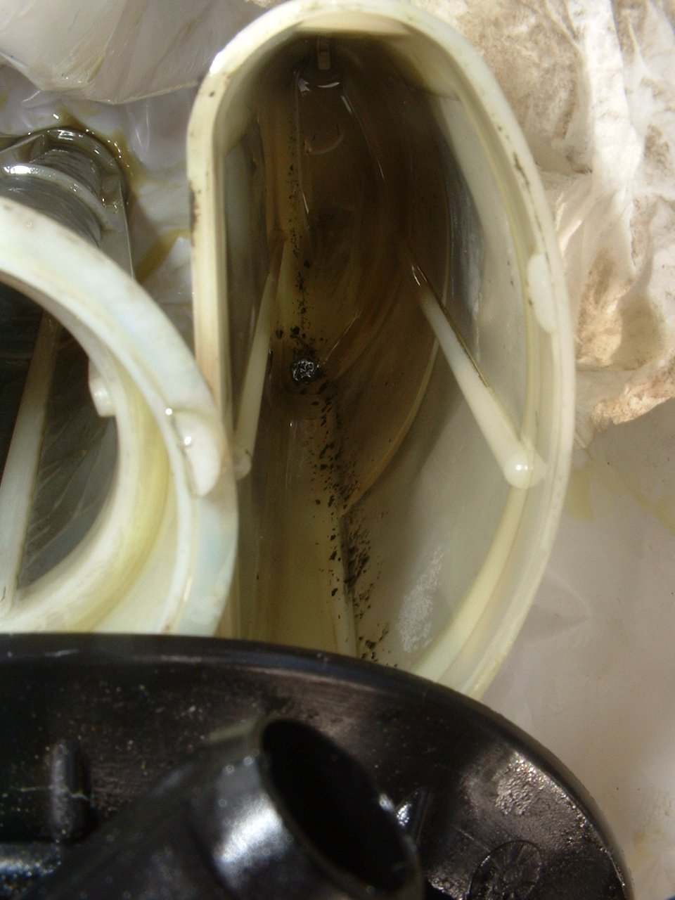

I think it would be fair to say that the previous large pieces of debris would point to the filters never being cleaned :?:
Skull's HDi post Hydraflush D filter
Skull's HDi D filter cleaned
Well 3,067 miles have gone pretty fast .....fully drained the tank and filters again although there really was less in them than expected .....

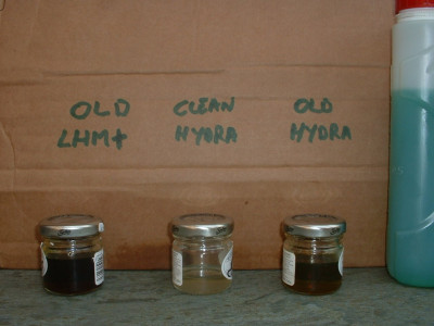

Just for comparison a picture of the fluids pre and post flush. (All taste the same :rofl2: )
Skull's HDi fluids
Skull's HDi fluids
The ABS symptoms have eased whilst the Hydraflush has been active but never disappeared at low speed crawl in traffic conditions.
The short test drive would suggest that's still the same .....
