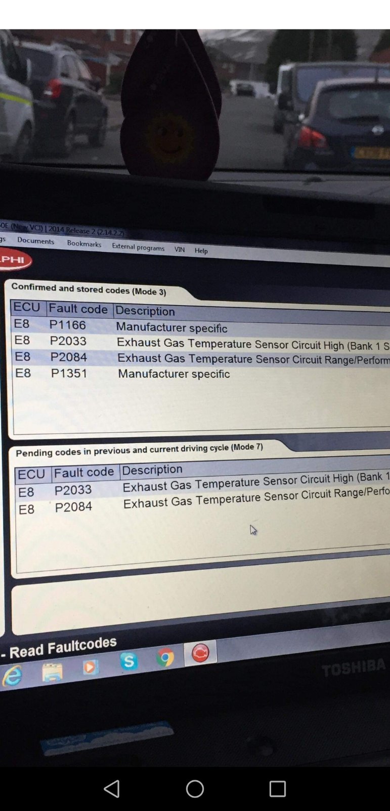

Hi. We managed to get the car plugged in and it came up with code p2033 and P2084. Exhaust gas temperature sensor. Any one know Location of this.? Is it going to be costly? Need to sort it as Mot in October and I don't want to get rid of her. No limp mode or anything she is running OK. Engine light on. Any way of bypassing it.
- x 6955
Re: Exhaust gas temperature sensor
I'll need your VIN. I see there are some manufacturer-specific codes too from the screenshot. Once I have the VIN I can take a look as to how they relate to your specific engine. Generic third party diagnostic kits can't always access these specific codes.

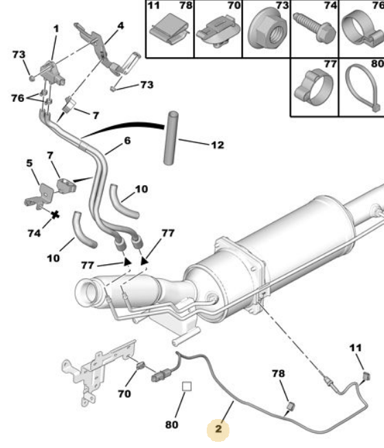

Don't get these confused with the DPF differential pressure sensors which have one up and downstream of the exhaust. With the gas temperature sensor there is only one of these - item 2 on a DW10BTED4 engine as an example.NewcastleFalcon wrote: 20 Sep 2019, 09:35 I have just replaced an Exhaust Gas temperature Sensor on my Vectra. On the VEctra there are 2 one upstream of the DPF, and one Downstream of the DPF.

Ok, so here are the faults codes:
P1166
High pressure fuel regulation: Measured rail pressure higher than the maximum pressure. The pressure of the fuel high pressure common injection rail measured higher than the maximum pressure of 1800 bars for 6 seconds
Fault disappearance: Driving for 5 min with several full load accelerations for 10 seconds
Down Grade Modes when this fault is present:
Suspect:
P1351
Is a common fault and means the glow plug relay is supplied and the plugs aren’t – so either the relay is not closing down on command from the ECU for 5 seconds.
Could be the glow plug relay or on or more of the glow plug (s). A relay change may be the easiest option to check first.
P2033
Catalytic converter downstream temperature signal: Voltage too high. The voltage of the signal of temperature downstream of the catalytic converter is higher than 4,98 V for 2s.
Symptoms: Lack of power
Suspect:
Catalytic converter downstream temperature signal: Value received incorrect. The voltage value of the temperature downstream of the catalytic converter is incorrect (For 1500 ms)
Suspect:
As mentioned this is the Exhaust Gas Temperature Sensor (item 2). This is part number 1618PG. It is currently £139.63 inc. VAT from Citroen.
An Original new Part here One here for £98

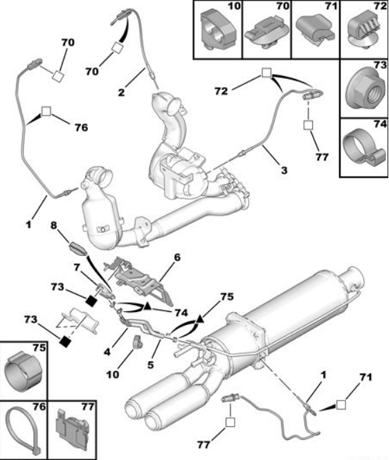

Have a look for comparison on a 2.7 HDi here Neil - same on the 3.0 - you can see there are 2 Exhaust Gas Temp Sensors at (2) & (3), plus the two at (1) in addition to the DPF differential pressure pipe and sensors at (4) & (5). I can only see one marked for the OPs engine though.
