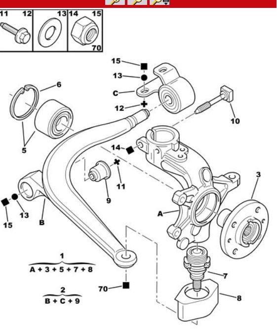

Can anyone with access to such things provide some diagrams of how everything fits together? The engineer in me wants to visualise what's going on...

Generic picture

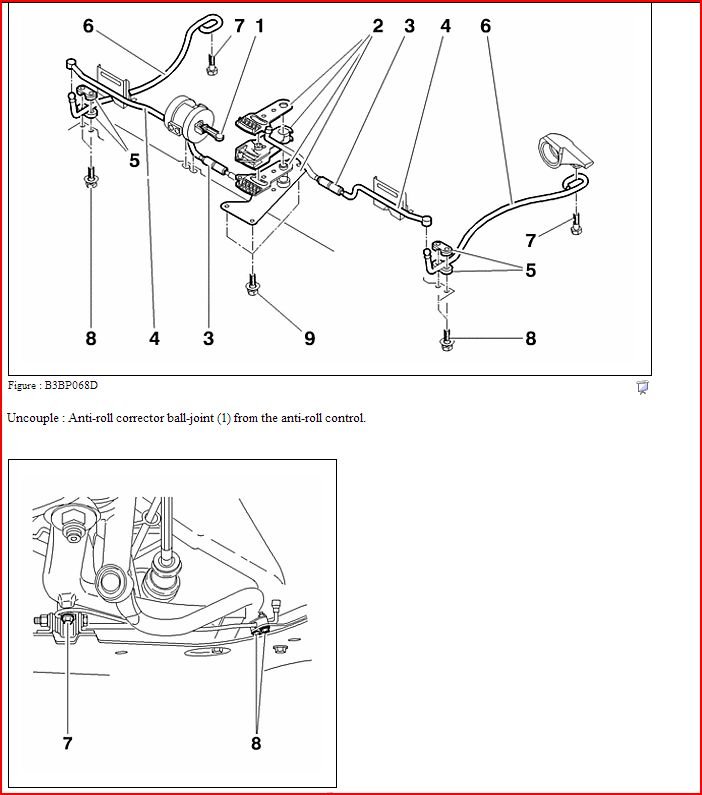

Item 9 is the front bush. IIRC there is something odd about the Activa arms in that they have a threaded bush on them, and something is screwed in, so you will have to fit new bushes. I suspect the job is best left to a specialist as well, as it probably involves re-setting the Activa control rods.

Yep.... here's the drawing about removing the roll control linkage - you can see that it is bolted to the bottom of the arm by the front bush (at 7) - I presume the bolts (8) are bolted to the end of the subframe. This will need to be removed I imagine to get the arm out - it's well known that people not in the know bend up the roll bar to get the arm back in on 'normal' cars, which can bend / break the height corrector connection - this must be amplified 10 fold when the Activa bit is taken into account. I also think that putting the front bush in a bit tricky as the arm is not square. If it was mine, in your position, I would be thinking about a trundle down the M1 to BL Autos!!
