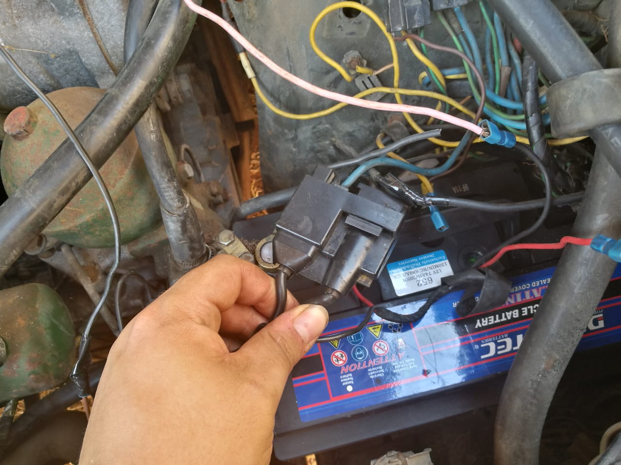

One pointer that you might find useful: the wire that goes to the starter solenoid from the ignition switch (whether there's a starter inhibitor relay or not) has a bullet connector that is found usually right above the battery. If you unplug it and touch the male connector to the positive battery terminal - right near it- the starter motor runs. It's ideal for starting the car without using the ignition switch and for checking valve clearances, timing, etc. If I recall, on early cars it's a thick yellow wire on its own routed alongside the series of multi plugs that come out the battery positive. It may also be red. It might be this that the former owner was talking about.
It put me in mind of the DS with the starter relay inside the battery terminal with a manual button on it for the same purpose.

Ah, the problem with mine is that the car with it's original owner went in for a service on the drive shafts, and halfway through that service, the old man died. This left the car without wheel-hubs, and I think they were going to do a radiator service on it too since the radiator is full of marks from radiator sealer and there's missing fins on the bottom left corner. As a result I'm missing my radiator fans entirely and I am also missing the grill that goes at the bottom under the radiator and fan.
Some of my wires have been disconnected and I found that some have also been cut off entirely and I do not know why.
There's one of the wires that have been cut. The pink cable connecting to the black cable is what my Dad did to start the car. That's the disconnected solenoid cable, and the relay it's supposed to plug into is completely missing.

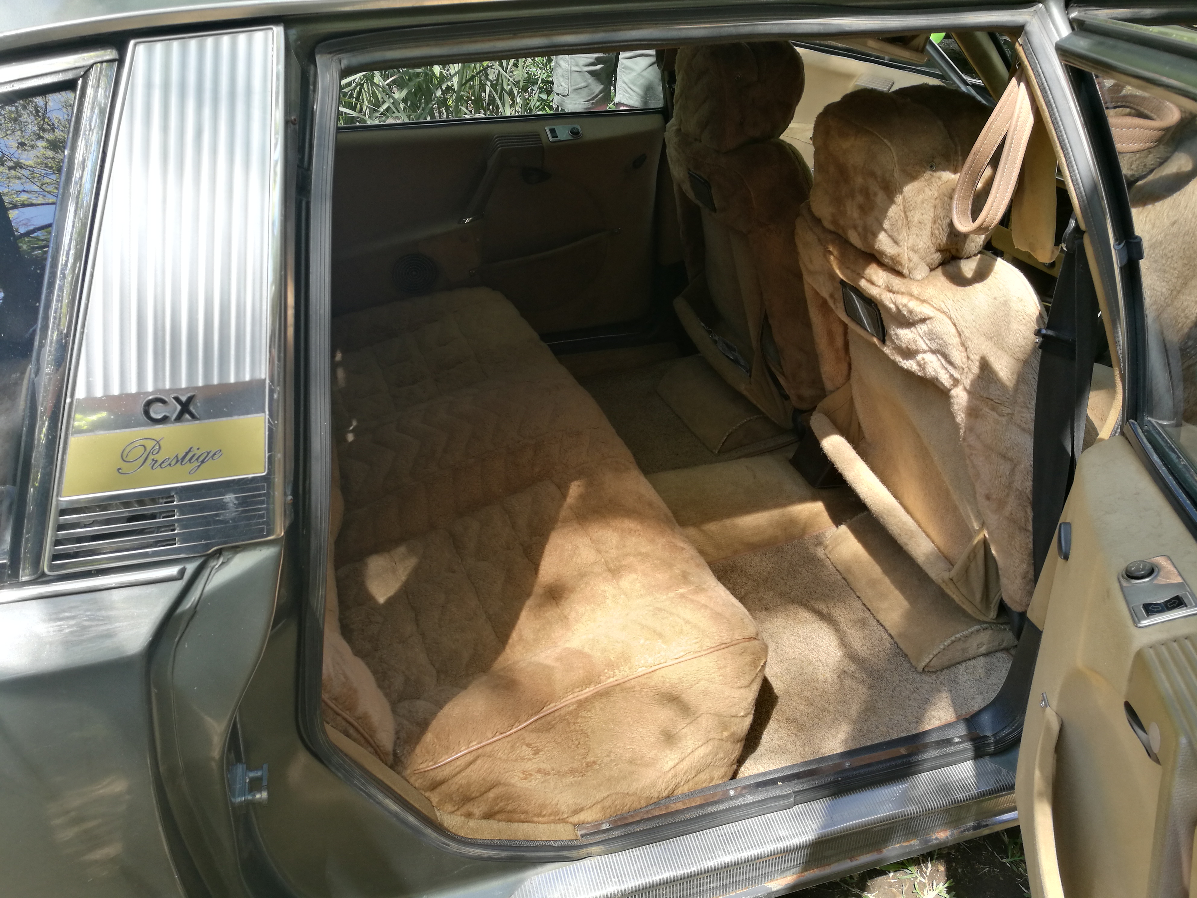

I have indeed taken pictures of the interior back when it was still on the previous Owner's yard.
I've since removed the faded yellow resin from the wheel and currently only the tiny metal strip with the cursive "Prestige" remains in the wheel. I want to have a new piece of resign cast to replace the old one so that I can preserve that little plate.
The interior is in otherwise very good condition. I hate the seat material but it is what it is, the cloth on the forward pillar by the right side is missing so I'll have to have that replaced.

Wow I don't recall previously seeing this type of upholstery in a Prestige! I wonder if it is a custom job. Looks good with the chevron stitching.
Graeme M
x 6947
Re: Restoring my 1981 Citroen CX Prestige
Mine was the same colour and had the foot rests in the rear, but didn’t have the ‘fluffy’ seats. But then again mine was an older (1978) model and was a C-Matic, otherwise very similar. Room for a pony and a disco in the back.
