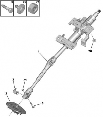

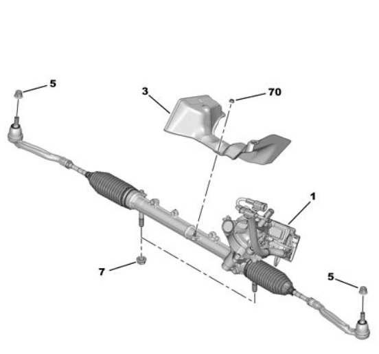

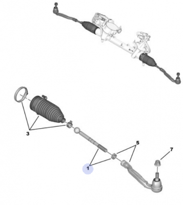

Steering ColumnSteering RackRods, Joint & Gaiters

Unread post by mara- »
Steering column finishes inside the car, in the part labeled with number 2 (steering gasket). After this, where is connection to the steering rack, inside engine bay? Is there some shaft between steering column gasket to the rack?
