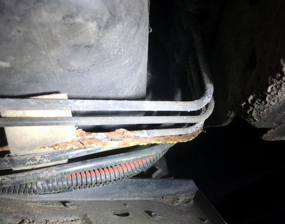

I mustered some enthusiasm today and had a look where the hydraulic feed pipes are located in the N/S plastic conduit. I could see where they part removed the conduit toward the rear to expose said defective pipe, chalked in yellow (pic enclosed). I'm surprised this has corroded as much as it has, given the adjacent pipes look quite healthy. Are these kunifer? The corrosion does creep up around the bend and partway onto the vertical section which then disappears over the rear subframe. Looks like access to this will be difficult for replacement.
The MOT certificate states:
Brake pipe excessively corroded Offside (front to rear main) 1.1.11 (c)
Brake pipe corroded, covered in grease or other material Nearside (front to rear main) 1.1.11(c)
I haven't removed all of the conduit yet, but I could see some corrosion further forward. I couldn't see anything obvious where the pipes emerge at the forward end, but really I need to get properly under the car to be sure and remove more of the conduit. I also couldn't see where the grease / other material is on the N/S pipe.

Oooo crusty!! Looks too far gone for a clean up.... I wonder if that might be the low pressure return, given that it has not given up the ghost yet. Usually you have to drop the corner of the subframe to get the new ones in there.

The original Xantia pipes are all steel, and (at least on the mk1) were painted at the factory to prevent corrosion, perhaps the paint nozzle was blocked when that one went through? It does seem that the corrosion protection on mk1 Xantia pipes was much more effective than that on the later cars.

It could be someone has tried to protect them with conduit but the metal pipes are not normally covered (except by that tray) I presume they took it off to mark but I've never seen any MOT tester do that :?: That photo looks to show 2 pipes in need of replacement, the worst one looks as though it's the 3.5mm from safety valve (mounted on nsf subframe) through a narrow / restrictive channel that enters the long plastic pipe tray on nearside and goes to rear brake valve via the top of the rear subframe, I have managed to replace mine full length but because I had the pipe made up with the unions already fitted it wouldn't fit through the narrow gap at the front subframe, if you change full length I would suggest running bare pipe through the tight areas and then flaring and fitting unions to the ends.
viewtopic.php?t=60982
Shows my trouble but if I was you I would try to renew from just inside the pipe tray to the rear brake valve - that will be hard enough 8-[
I'd also have a look around your osr brake / suspension lines as that may be the different pipe area indicated on the fail sheet :?:
Good Luck
EDIT Having re-read that I think it might just be the 2 pipes in your photo :?:
