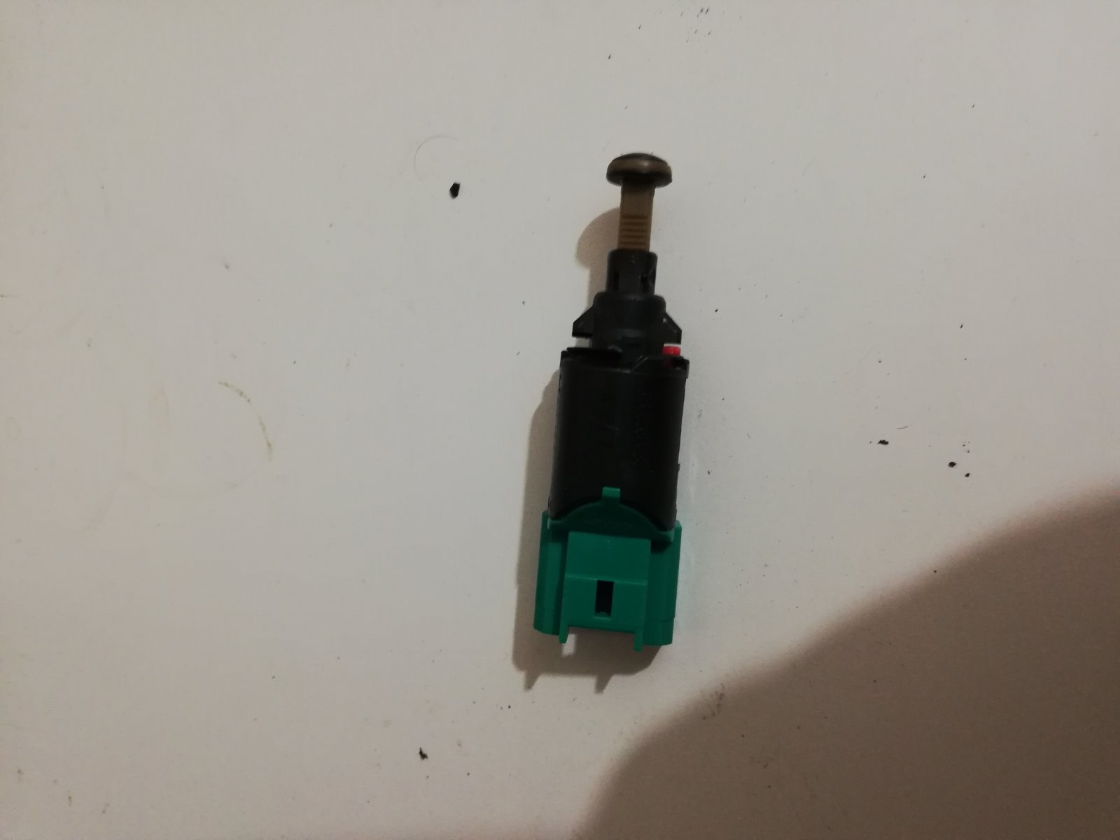

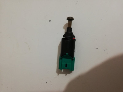

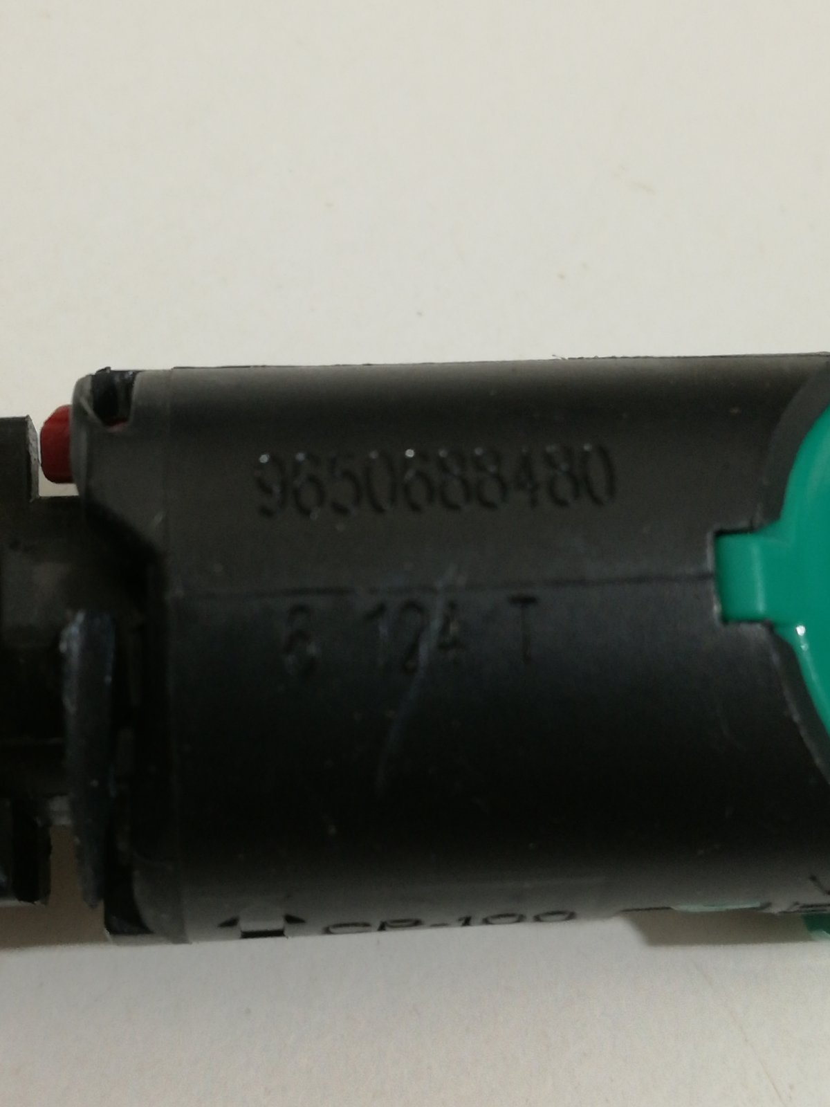

My c5 is mk1 facelift automatic transmission. I changed one brake switch which is bottom of the pendal. Where is the other?

Re: Cruise control system faulty
It may well be that there are TWO switches in one casing. How many pins are there in the connector? If there are four it has both switches. They operate in opposition with each other; one is a push-to-make switch (mainly used for the brake lights), with the other is a push-to-break (mainly to disconnect the cruise control). As the connector can only go in one way around you don't need to worry about getting the switch connected up the wrong way around. If you use a multi-meter you can test both switches to see if they are working properly.
