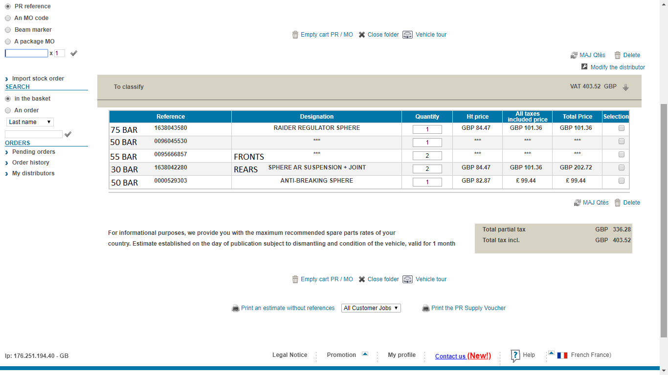

Can anyone confirm the correct Accumulator sphere for my car

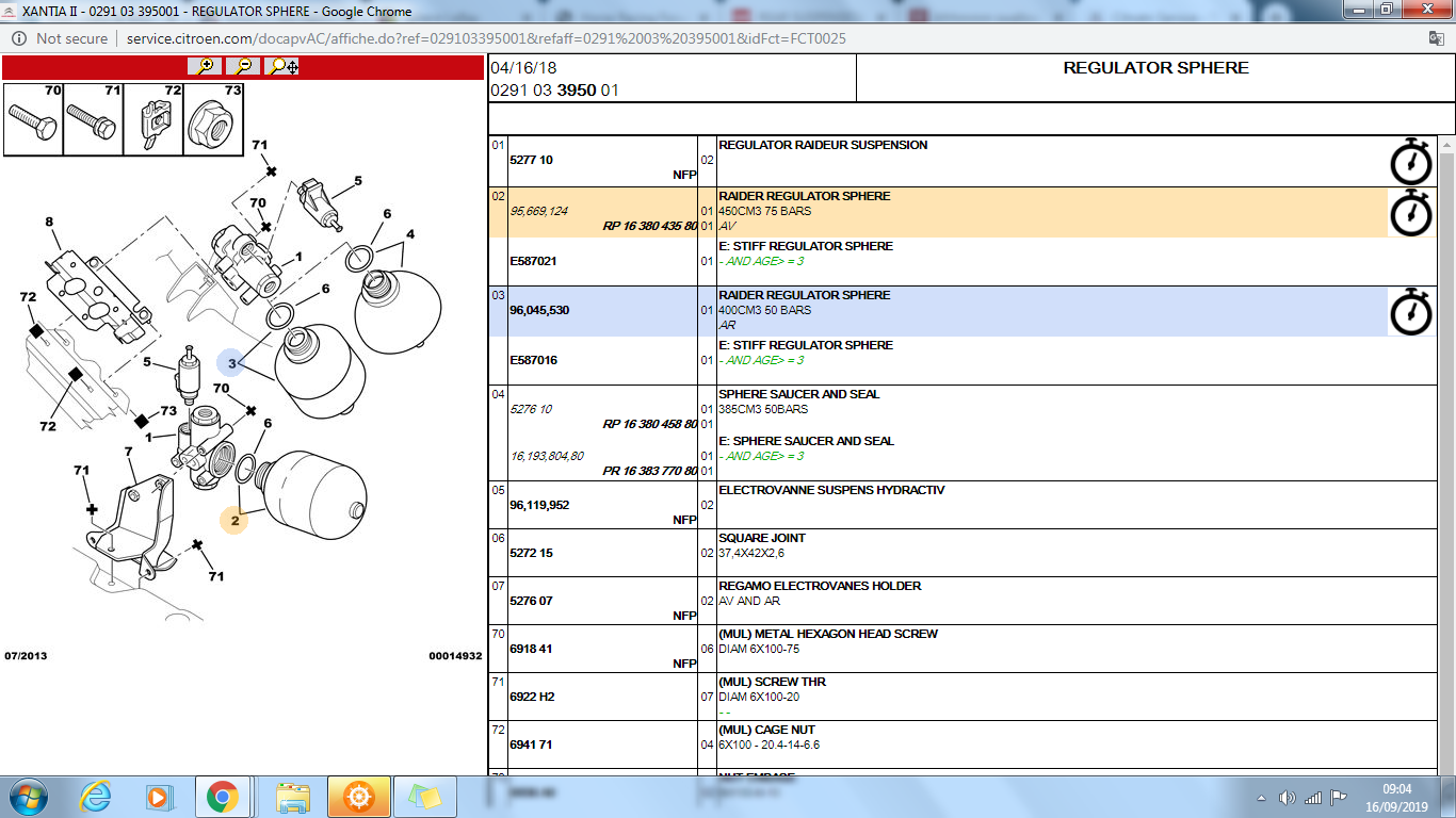

Citroen Service list 2 options (top 2 lines in table) for my specific car as detailed but they don't look right as the seem to be hydractive spheres
I think mine should be 62 BAR but can only see stamped "ACC 95437354" "9 - 1 94" which doesn't appear on Citroen Service.

Re: SPHERES for XANTIA 2.0 HDi
You are on the wrong page. Confusion because Citroen call hydractive spheres regulator spheres.
The regulator they call the circuit breaker.

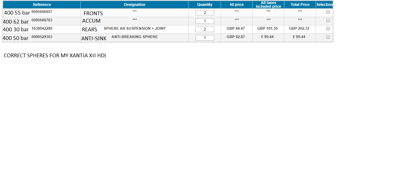

Cheers Activa_V6
>Suspension
>Contactor
= ACCUMULATOR 95666763 62 BAR
