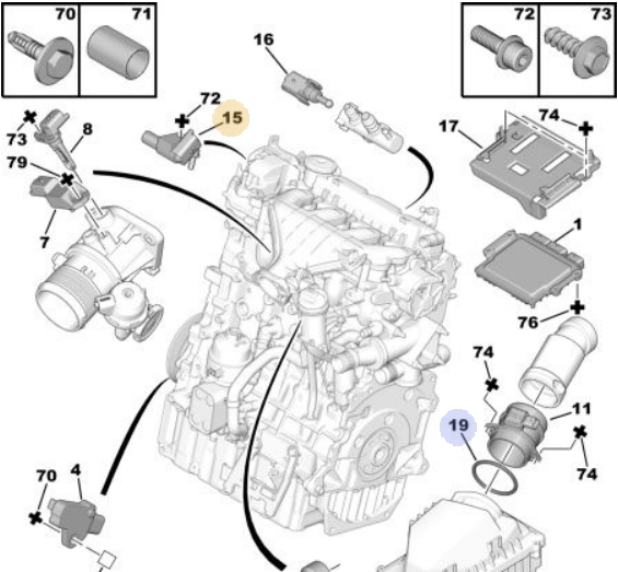

Are you sure? P0344 is not listed as a fault code against the Delphi 3.4 engine management system on your vehicle.
P0341 and P0342 are though....
P0341 is a problem with synchronisation of the camshaft.
P0342 is a Camshaft sensor - loss of the camshaft signal.
In either case it may be worth replacing the sensor to see if that resolves the issue as both of the above codes relate to the sensor for the most part. Item (15) on the diagram.
