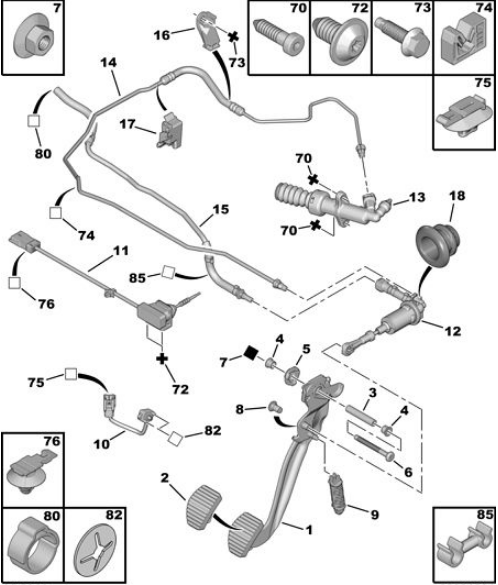

Re: Squeaky noise
I have the VIN already.
It's possible that it is simply the spring: See item 9 on the diagram - it's the declutching spring. Some thick grease may help.

Re: Squeaky noise
Just checked that spring defiantly seems to be under the bonnet the noise only happens when pressed down on release there is no sound at all.

Re: Squeaky noise
I wonder do these suffer from metal fatigue at the pedal mounting bracket? Any distortion would produce a creak when loaded (pedal down)GiveMeABreak wrote: 13 Sep 2019, 16:12 I have the VIN already.
