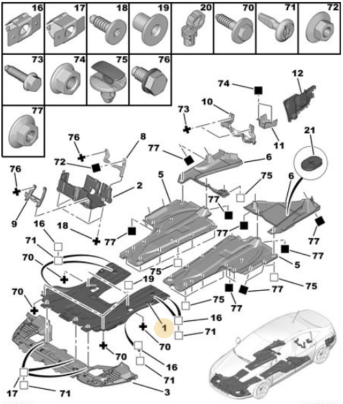

My C5 had no undertray when I bought it. I hope to quiet the racket of the 180k mile 2.0 diesel a little by replacing it.
I have looked in the parts software for my VIN it offers two different shapes with no extra info to work out which one I would need.
Does anyone know which part number I want?
My VIN VF7**************[VIN obfuscated, can be read by forum staff]
Undertray for C5 X7 Tourer 2.0 HDI Exclusive

There are multiple parts - each are different - depends which ones you want - your C5 has them all.
(1) Engine and gearbox soundproofing (Part: 7013T7)
(3) Front Engine Air Deflector (Part: 7013GH)
(5) Left (Part: 7013R5) and (5) Right (Part: 7013R7) Engine Air Deflectors
(6) Left (Part: 7013FG) and (6) Right (Part: 7013FH) Engine Air Deflectors
If it's the main Engine and Gearbox soundproofing (Item 1), better get the crown Jewels up for auction: £263.22 inc. VAT from Citroen.
