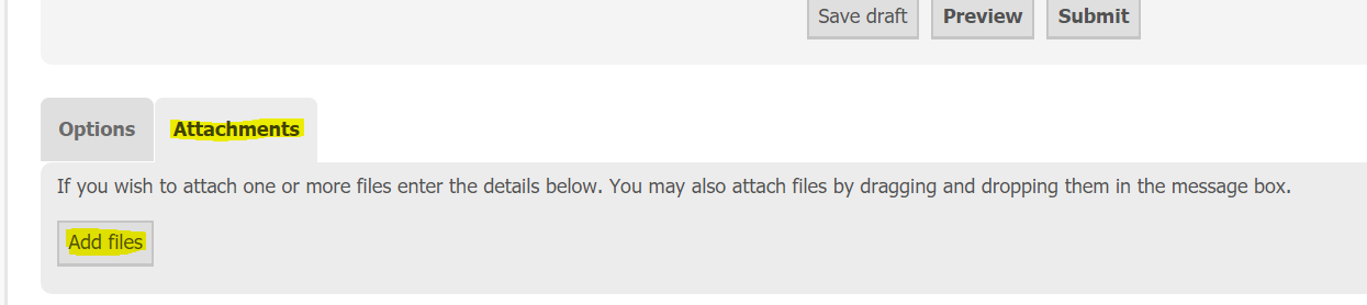

4) Upload the screenshots here (please don't put links to other image hosting sites - this makes it hard for me to keep switching about). You can use the full post editor, select attachments tab at the bottom:
Then place them one per line.

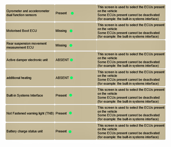

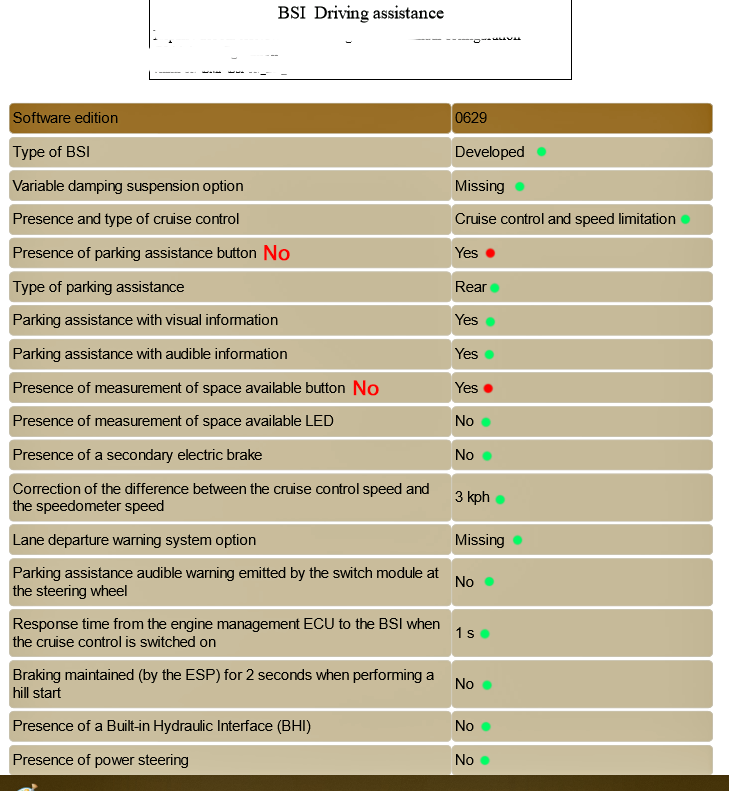

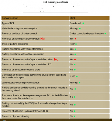

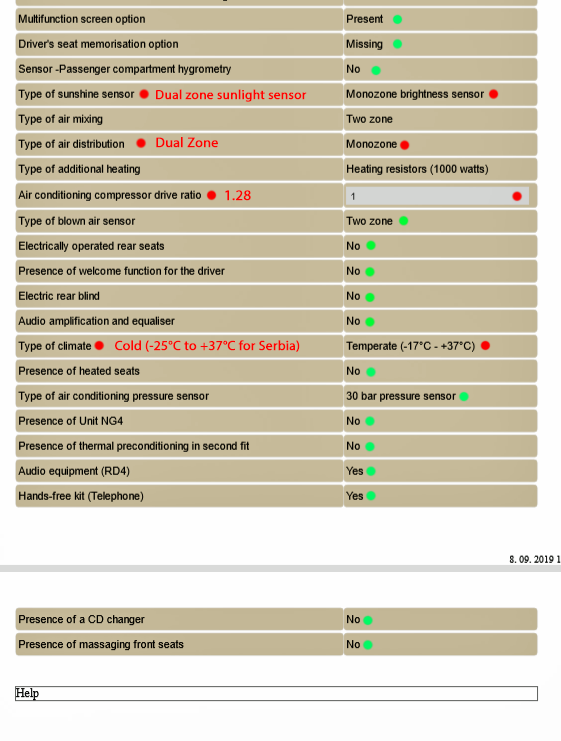

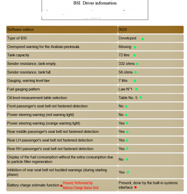

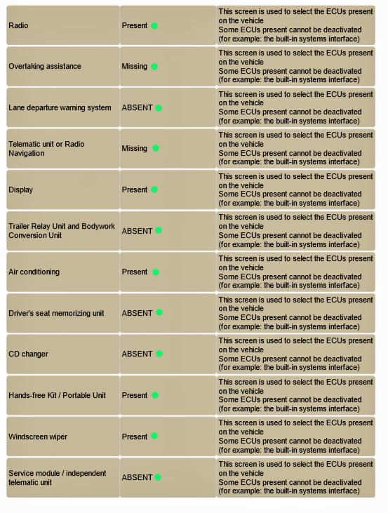

BSI's are NOT for playing with - period - it can result in a non-starting vehicle or worse affect the operation of the vehicle safety wise.

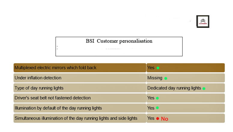

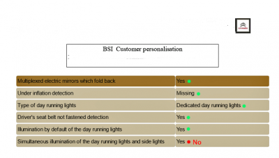

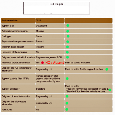

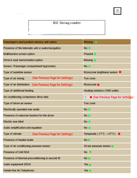

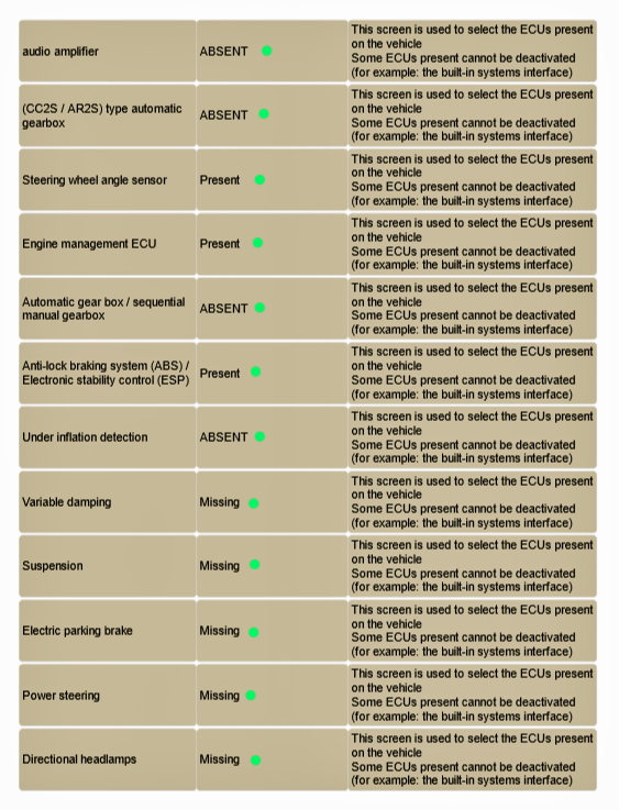

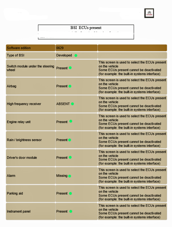

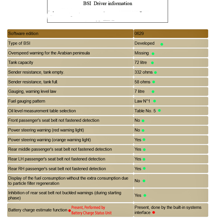

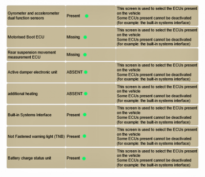

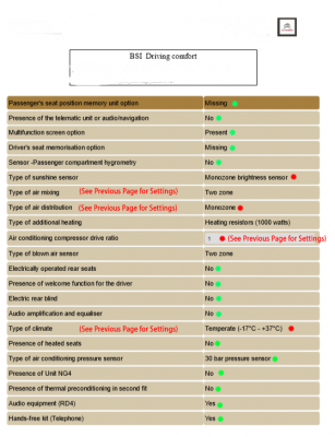

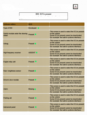

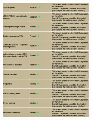

Ok, after receipt of your screen printouts via PM, it has taken me a few hours to compare, but here are my findings:
I have marked the wrong settings in red and put the correct entries. Some entries are duplicated on several screens - but they should update the second location once you have configured them in one place.
I have marked the Battery Management as an error as it should be managed by the Battery Charge Status Unit (unless you deliberately want it changed back to be managed by the BSI as per the post in the Forum that I did) - your choice, but I marked it to what the default is.
Your Rain / sunshine sensor settings were wrong along with the climate control - you have Bizone Automatic Air conditioning and that means a Bizone sensor - so I have corrected all that.
As for the Country climate temperatures - the car I assume was not originally bought in Serbia - but as you have that as your location on your Forum Avatar, I have recommended you change the temperate settings as there is one for Serbia and that is listed as a Cold Country.
So all the ones that are ok as far as I can see are marked in Green and all the Red marked entries should be changed to the entries I have marked in red Text.
Regards
Note! These settings are specifically and uniquely for the specific member's vehicle (Magnus) in case anyone is casually browsing. Please do not apply these to your own vehicle.
Click Images to Zoom
