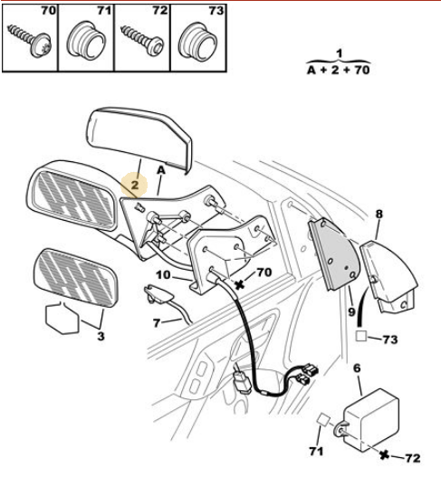

No, they're not the same - they differ depending on options.
For your Xantia, the part is 8148WA for the left hand side Passenger on a RHD). Of course no longer available from Citroen now.
However the outer shell (2) on the diagram is still showing as available (unpainted), part: 95668006.

Re: Wing Mirror Replacement
There are several versions each for right and left hand drive models and with / without the indexing option. The indexing one also has a control module inside the door (item 6 in the diagram). I can't tell you what other differences there are internally to the mirror, but there must be some - otherwise they would all be the same part with just the the control module included or not.

It is a few years since I had to work on one of these, but my recollection is that all electric mirrors for Xantias from about 1996 (including late mk 1) use the same casing and top cover, but the motor module and wiring harness varies with mk1/mk2 and whether dipping or not. I am sure that I made a good mirror with a mix of parts retrieved from dipping and non-dipping models.
