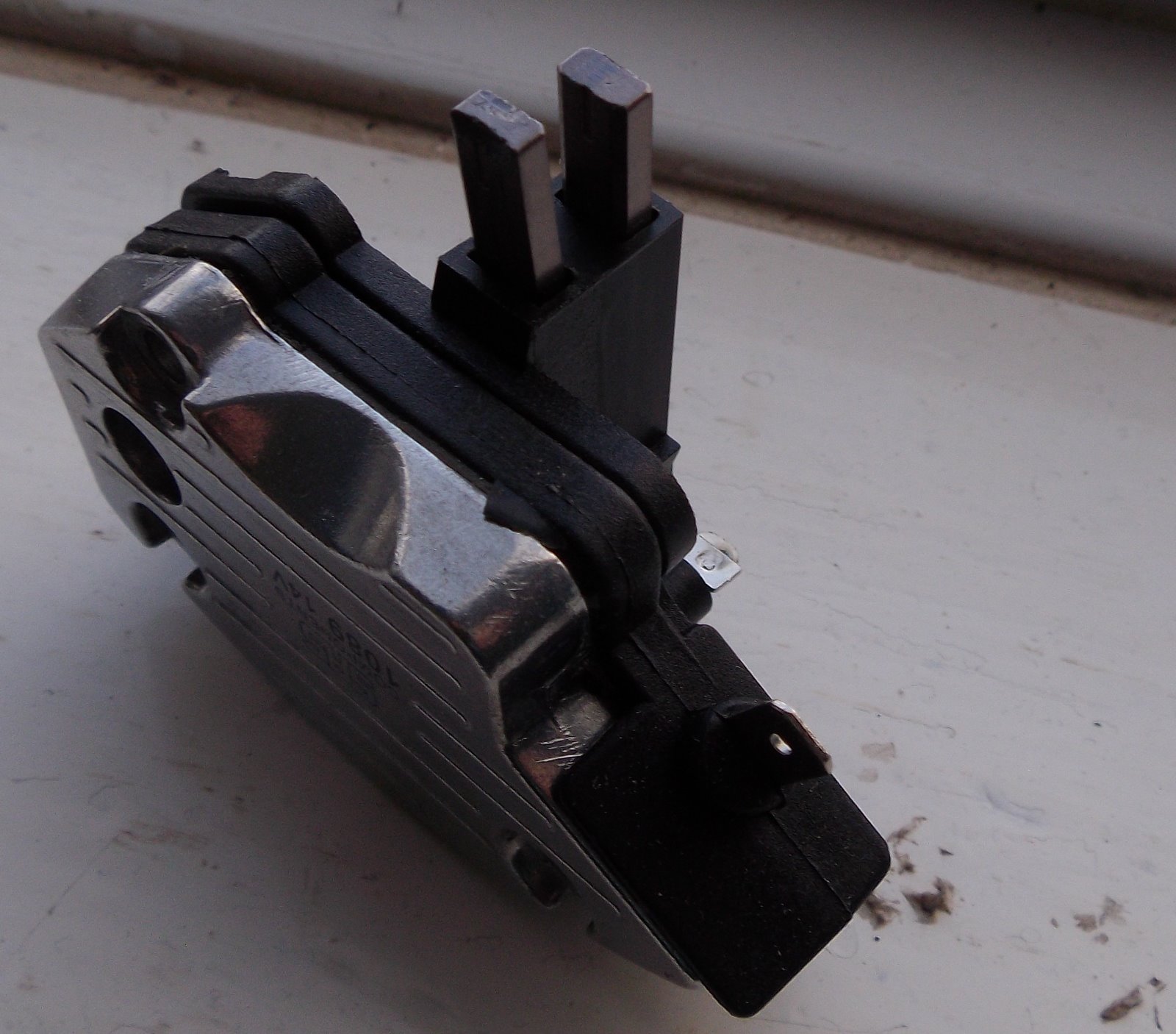

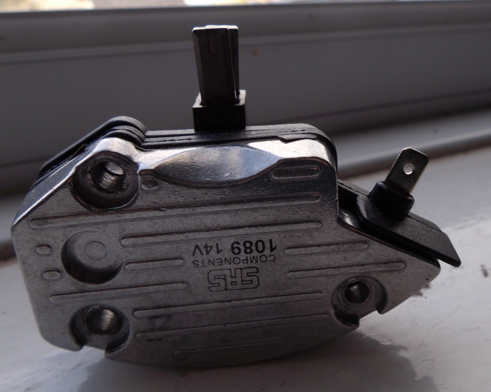

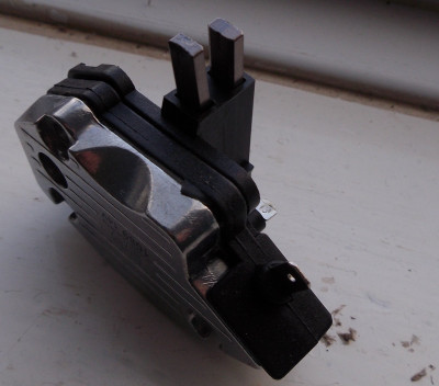

Might I suggest you take a very good look at the alternator. I had, years ago in the past, a BX whose alternator stopped working. I replacement was (then) around £80. However, it was just the brushes that had failed (well, worn out). I got a replacement set (a little module that just bolted into place) for around £15 and the alternator started working properly again.
- x 2941
Re: C5 alternator removal
This is the sort of thing James is referring to. This is a new Lucas on that's been sitting in my drawer for years.

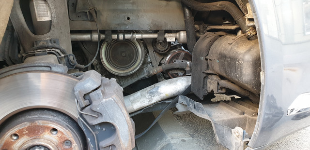

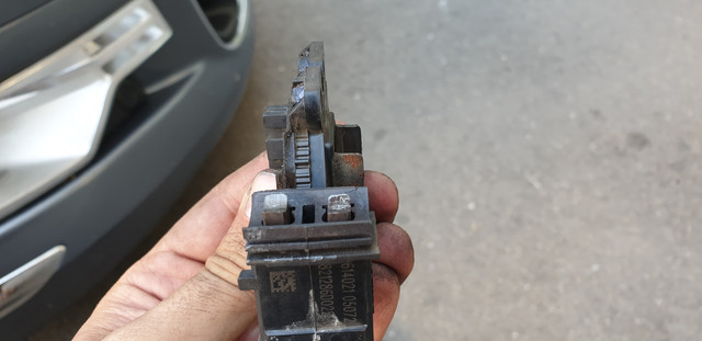

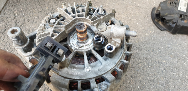

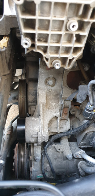

Just finished to mount the alternator back, as expected the brushes were worn. I've change also the bearings and the alternator pulley at a local garage, the slip sings are ok.
Few steps to remove the alternator, the job is quite simple.
1. Remove the wheel from alternator side.
2. Remove the accessory belt
3. Remove the two plastics where the oil filling hose is mounted
4. Remove the 3 bolts and the clamp that is underneath the alternator in the right side.
Some pictures..
Thanks all!
Some pictures..
Thanks all!

So new brushes could well revive that alternator. Cleaning up the copper contacts would also help.
