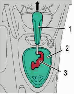

Right you have a late registered C5 MK II not an X7. I will remove the earlier post as although the same procedure, the diagrams are different:
You still have an AM6 box, albeit an earlier version.
The causes of malfunction can arise from the following elements:
- "shift lock"
- Gear lever position switch
- Automatic gearbox ECU
- Electrical harness
- Battery voltage

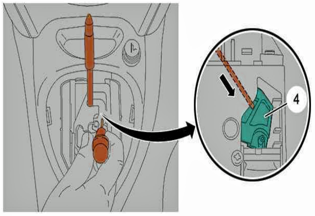

Remove:
| Release the "shift lock" ( 4) using a flat screwdriver. Move the selector lever to disengage it from the " P" position. |
