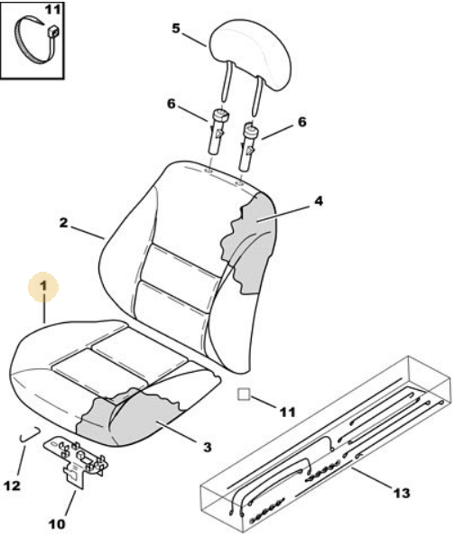

I have an HDI SX with a tired driver's seat.
I'm thinking of buying just the base cushion by post from a breaker.
Can anyone tell me whether it is symmetrical side to side, so I might ask for the less worn passenger side instead?
I've had one of the seats out, when the underlay and carpet were soaked, but I didn't look at the underside. Would it reasonably easy to remove and swap sides, or are there snags with brackets or airbag loom, anything, and better to have driver's side after all?

The base seat on the S2 is the same for left and right - only the trim colour / finishes are different item (1):

Thank you. I'll ask for the left.
