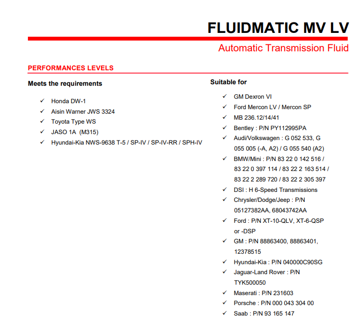

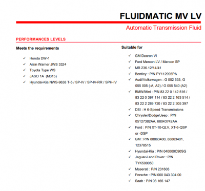

Thanks, but it seems you missed the LV in the naming. Total Fluidmatic MV LV.
https://catalog.lubricants.total.com/en ... ATIC-MV-LV
Datasheet shows Aisin Warner JWS 3324, so it should be compatible?
- x 6956
Re: EAT 6 - is this correct oil?
I'm just saying that it does not refer to any PSA marques on the approved list....
Yeah, I know, but it is Aisin gearbox in the car, and spec match, so in you opinion, could it be used?
- x 6956
Aisin make a lot of gearboxes including all the AM6 versions for PSA and the EAT 6, however they can use different oil specifications as I've said. If I was looking for an equivalent - I would only be happy if the part numbers of the oil matched the OEM part number and it specified the part number. That's my opinion but it must be your own choice. I would be questioning why they have not included a large manufacturer such as Peugeot, Citroen and DS Automobiles in the list ????? That would be my warning flag.
