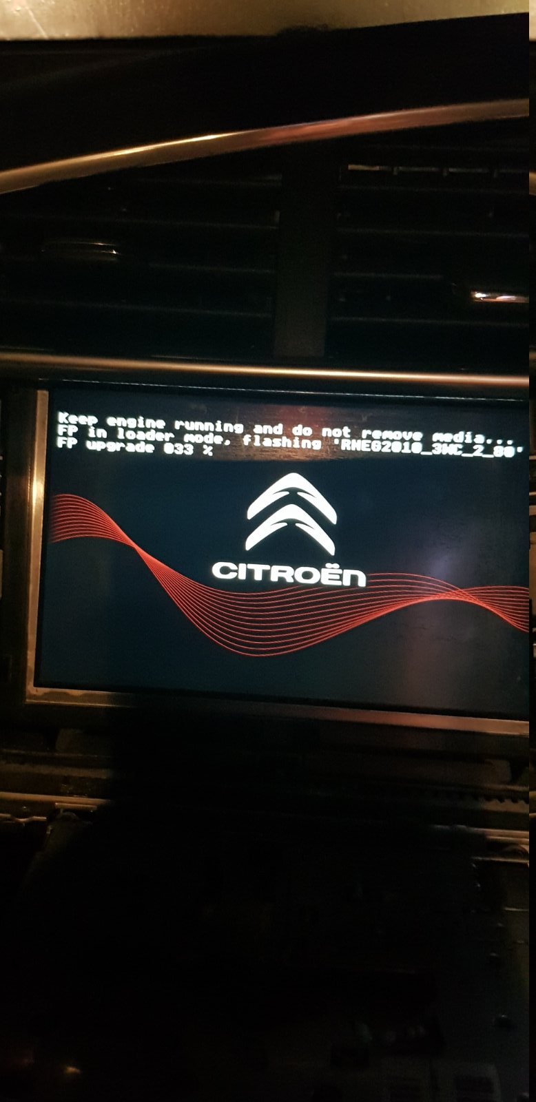

ImageOk scrub that
The screen is working fine.. I have this

Post by GiveMeABreak »
Ok good news. It could of been trying to load before and kept getting interrupted. This is a big update, so give it time and let it finish. It will reboot itself, but leave the USB in until it tells you to remove it.
Remember, after this update, if all goes well, you may find some issues with parking sensors playing up and other info may not be displayed. If this happens it needs the parameters configuring again. Diagbix will be needed to do this. Let us know how it goes.
