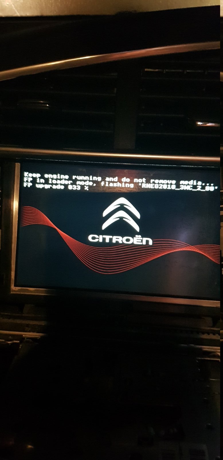

Re: How to Replace the Internal MicroSD Card - RT6
Ok scrub that
The screen is working fine.. I have this
Ok good news. It could of been trying to load before and kept getting interrupted. This is a big update, so give it time and let it finish. It will reboot itself, but leave the USB in until it tells you to remove it.
Remember, after this update, if all goes well, you may find some issues with parking sensors playing up and other info may not be displayed. If this happens it needs the parameters configuring again. Diagbix will be needed to do this. Let us know how it goes.
