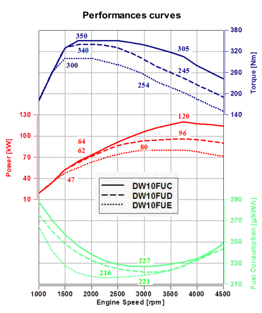

The differences between these three variants are the power curves:

Ok, so confirmed, you have the DW10FUD engine. So your performance curve data will be in the second image with the large marching ants.
