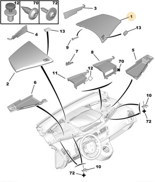

Ok, sitting comfortably with a glass of strong Vino?
Both these lids are available parts (1) & (2) below:
Lid (1) part 8218LA - £359.66
Lid (2) part 8218LC - £359.66
Both inc. VAT of course!
So at least you can try and source these on the breaker / spares circuit now with the part numbers

Thanks Marc for your work. Even at 1/10 of that price I would call them expensive!
